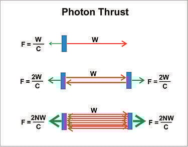

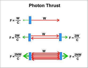

If you have a mirrored surface to bounce laser light between you can get thousands of times the ##\Delta{v}##.
There is, of course, a limitation based on red shift. You cannot harvest more kinetic energy from the light than went into the light in the first place.
In the limit, you are effectively pushing off from the mirror.
It's been done in the lab
How can a laser move an object like that?
Of course, but if you can convert a few percent of the beam energy into useful kinetic energy rather than the miniscule ~##\frac{1}{c}## you get normally , you have something useful.
It can if it bounces over a thousand times.
