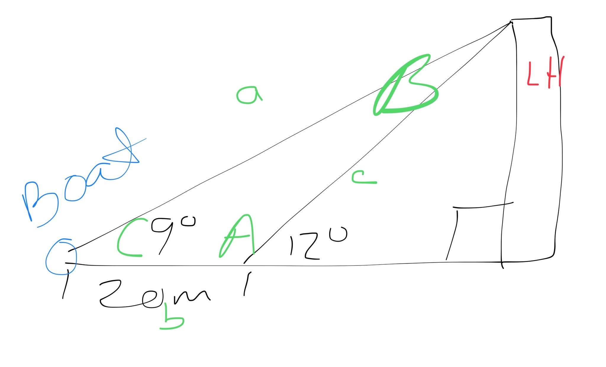

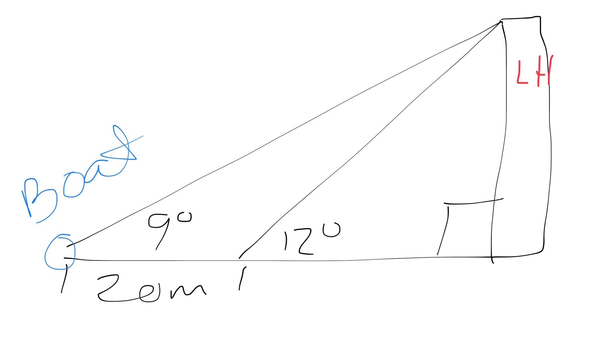

A boat is some distance away from a small lighthouse. The angle of elevation from the boat is 9 degrees. If the boat moves forward 20m, the angle is now 12. Assume the lighthouse is at a rightangle to the boat.
Calculate the distance from the boat to the top of the lighthouse before and after it moves

a/sinA = b/sinB = c/sinC
180 - 12 = 168
180 - (12+90) = 78
180 - (9+90) = 81
81 - 78 = 3 (top corner)
a/sin168 = 20/sin3
a = (20 x sin168)/sin3
a = 79.45
c/sin9 = 79.45/sin168
c = (79.45 x sin9)/sin168
c = 59.78
Correct?

I would let:
$$h$$ = the height of the lighthouse in meters
$$\theta_1$$ = the initial angle of inclination
$$\theta_2$$ = the final angle of inclination
$$x$$ = the final distance to the lighthouse in meters
Now, we may state:
$$\tan\left(\theta_1\right)=\frac{h}{x+20}$$
$$\tan\left(\theta_2\right)=\frac{h}{x}$$
Now, these equations imply:
$$h=x\tan\left(\theta_2\right)=(x+20)\tan\left(\theta_1\right)$$
Or:
$$x\tan\left(\theta_2\right)=(x+20)\tan\left(\theta_1\right)$$
Now, solve this for \(x\)...what do you get?
x0.2126=x0.1584+3.1677
x0.0542=3.1677
x=58.47
x0.0542=3.1677
x=58.47
I recommend solving the equation completely, then then plugging in the given values and rounding only at the very end.
$$x=\frac{20\tan\left(\theta_1\right)}{\tan\left(\theta_2\right)-\tan\left(\theta_1\right)}$$
Now plug in the given angles of inclination:
$$x=\frac{20\tan\left(9^{\circ}\right)}{\tan\left(12^{\circ}\right)-\tan\left(9^{\circ}\right)}\approx58.47452024794465$$
So, initially the boat was about 78.5 m from the lighthouse, and finally it was about 58.5 m from the lighthouse.

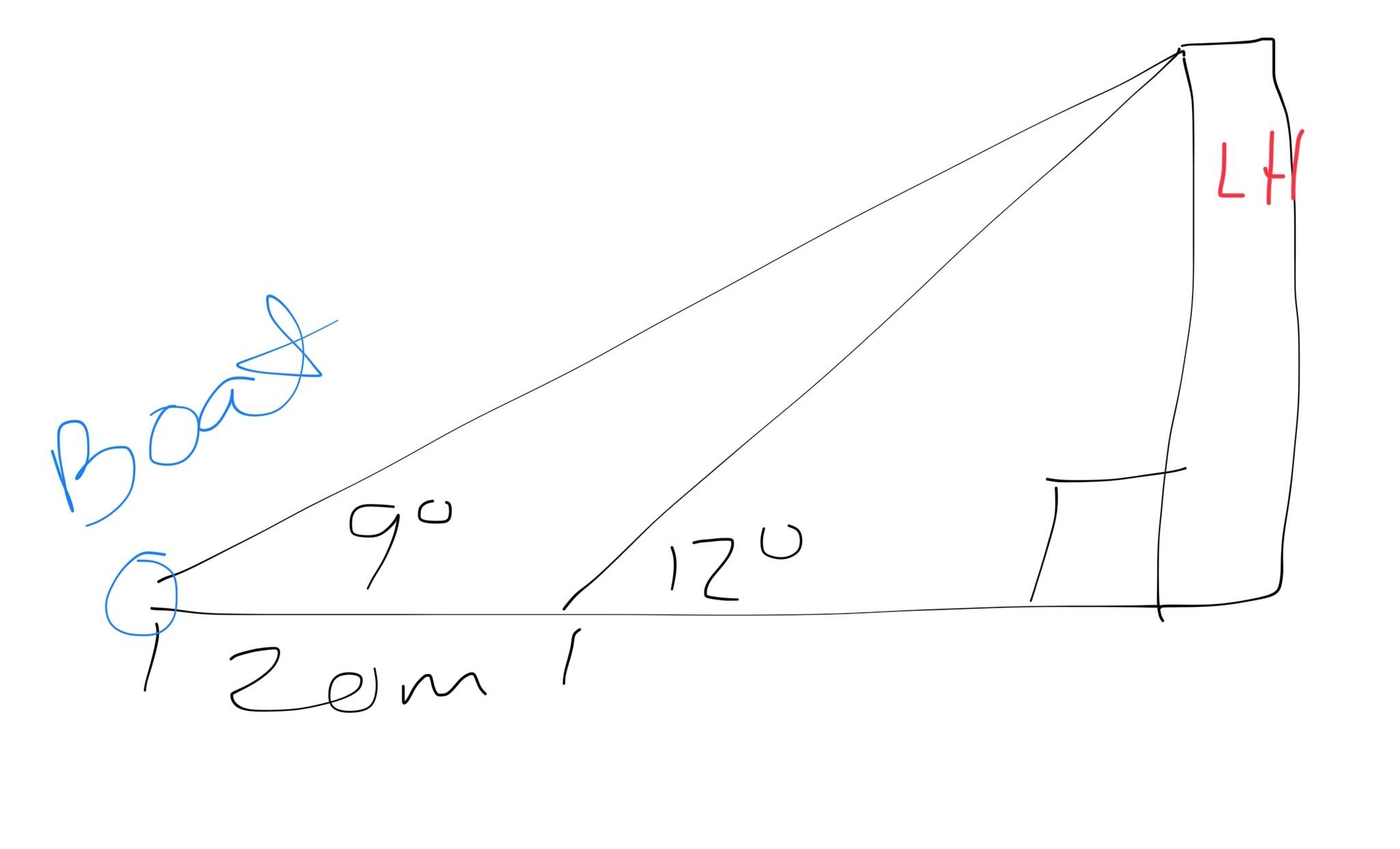

The problem is asking for the distances from the boat to the top of the lighthouse.
Oops...my bad. (Emo)
If we let \(d_1\) be the initial distance from the eye of the observer to the top of the lighthouse, and \(d_2\) be the final distance, and armed with the value of \(x\), we could state:
$$\cos\left(\theta_1\right)=\frac{x+20}{d_1}\implies d_1=(x+20)\sec\left(\theta_1\right)$$
$$\cos\left(\theta_2\right)=\frac{x}{d_2}\implies d_2=x\sec\left(\theta_2\right)$$
Now, it's just a matter of plugging in the data. :)
