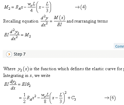

I am having a trouble understanding why the solutions manual is using u-substitution here. Am I forgetting a rule or something?
I don't know how to post in the correct notation so I'll post pictures instead.
I am suppose to integrate equation (4) in the picture. The solutions manual shows equation (6) as their answer. The answer I got is this:
= 1/2*RAx2 - woL/4(x2/2 - Lx/3) + C3
I believe they are using u-substitution for the (x-L/3). Am I doing something wrong?

The answer you give and the answer they give differ only by a constant. So both answers are correct.
