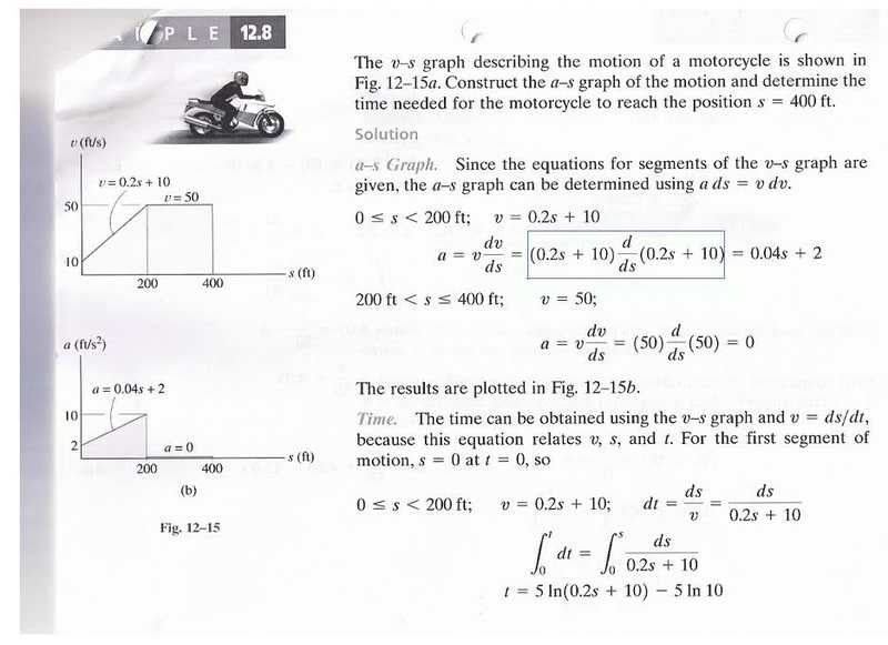

I don't understand what is happening after the a=v dv/ds statement. If someone could explain the steps using calculus to end up with a=0.04s + 2 I would really appreciate it. I am trying to figure it out by reading over my old calculus notes, but I can't make a connection between the two.
a=v dv/ds
I am just trying to follow along at this point. I don't understand what is happening after the a=v dv/ds statement. If someone could explain the steps using calculus to end up with a=0.04s + 2 I would really appreciate it.
The steps make use of a property of differentiation called the chain rule. It basically says that the derivative of a function with respect to one variable (e.g. x) can be expressed as the product of the derivative of that function with respect to another variable (e.g. y) times the derivative of y with respect to x (provided y also depends on x). That statement may have been difficult to parse, so here it is in equation form:

This is the chain rule for differentiation. In your example, the chain rule has been applied to the derivative of velocity with respect to time. Velocity is a function of time, v(t), but position is also a function of time s(t). therefore, using the chain rule, we can write:
[tex]a(t) = \frac{dv}{dt} = \frac{dv}{ds}\frac{ds}{dt}[/tex]​
Now, in this last step, ds/dt, which is the rate of change of position with time, is just velocity (v = ds/dt by definition). So, substituting v for ds/dt, the expression becomes:
[tex]a(t) = \frac{dv}{dt} = \frac{dv}{ds}v[/tex]​
Rewriting it in this way is useful because you already know the velocity as a function of position v(s) (rather than time). It is given to you in graphical format. So, the remaining steps are:
[tex]v(s) = 0.2s + 10[/tex]​

For this reason, the derivative of a constant function is zero, because n=0 in that case. Intuitively, a constant function doesn't change, so its rate of change is zero. In our particular example, we can apply these rules as follows:
[tex]v(s) = 0.2s^1 + 10[/tex]
[tex]\frac{dv}{ds} = \frac{d}{ds}(0.2s^1 + 10) = \frac{d}{ds}(0.2s^1) + \frac{d}{ds}(10) = 0.2s^0 + 0 = 0.2[/tex]​
Therefore:
[tex]v\frac{dv}{ds} = (0.2s + 10)(0.2) = 0.04s + 2[/tex]​
Thank you Cepheid, I understand now.
