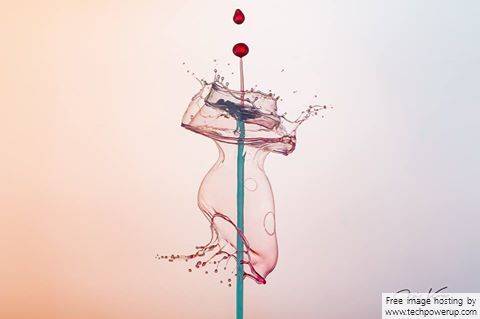

Ok not even sure if i am posting in the right are or not but here goes.. (Maybe a mod can move to right spot). As the title states I do Photography and I like to try all genres taking bits of knowledge along the way and incorporating it into other areas. Last year I started to do liquid art Photography which is a sub genre I guess you would call it of High-Speed. I have played with a few different things mixed with water, guar gum , xanthum gum and cornstarch as this helps to increase the viscosity of the water making it possible to capture many different shapes in the collisions etc. My question is can anyone help me with trying out some things I would never have thought of mixing with water or even something to use neat that may help me on my quest to make a better image? I have added an image to demonstrate what i am actually capturing and yes it is one of my images. :)

Thanks everyone for your replies, google have led me to discover locust bean gum and apparently when mixed with xanthum gum it makes things more viscous. My water drop kit currently has 3 valves up top and room for 3 more I have one other that i sometimes use from below pressurised with a weed sprayer. The image I posted was using the weed sprayer the outlet of the nozzle is 2mm to give and idea of the size.
