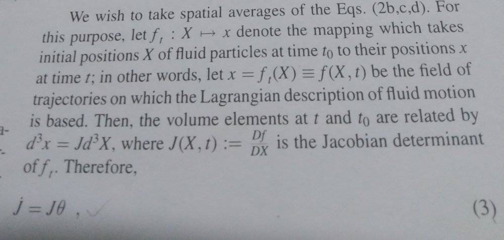

Ok the thing is it ,I came across an equation which is ##dx(t)dy(t)dz(t)=JdXdYdZ...(1)## where ##x,y,z## are cartesian components of the position vector and ##X,Y,Z## are constt of time.
and it is written that ##\dot J=J\theta## where ##\theta=\vec \nabla•\vec v## and ##\vec v## is the velocity vector.
In order to prove it I took time derivative of both sides of (1) for which Rhs become ##\dot J dXdYdZ## and for one part of LHS out of three parts it came as ##\frac{\partial v_x}{\partial x}+\frac{\partial v_x}{\partial t}\frac{\partial t}{\partial x}## and combining three terms it came as ##\theta##+extra terms
Then how to prove it??

Here is the snap where I tried to prove equation 3

Trying to prove eq.3 ...
Any hints to arrive at the result??
What I have tried is taking time derivative of ##d^3x=Jd^3X## which gives RHS ##\dot J d^3X##,for LHS simplying one term out of three e.g ##\frac{d(dx(t))}{dt}dy(t)dz(t)=dv_xdydz=(\frac{\partial v_x}{\partial x}dx+\frac{\partial v_y}{\partial y}dy+\frac{\partial v_z}{\partial z}dz+\frac{\partial v_x}{\partial t}dt)dydz##
Multiplying throughout by ##d^3x=Jd^3X##
Rhs becomes ##\frac{\dot J}{J}## and LHS becomes ##\frac{(\frac{\partial v_x}{\partial x}dx+\frac{\partial v_y}{\partial y}dy+\frac{\partial v_z}{\partial z}dz+\frac{\partial v_x}{\partial t}dt)}{dx}=\frac{\partial v_x}{\partial x}+\frac{\partial v_x}{\partial t}\frac{\partial t}{\partial x}##
Combining all three terms we get
##\frac{\partial v_x}{\partial x}+\frac{\partial v_x}{\partial t}\frac{\partial t}{\partial x}+\frac{\partial v_y}{\partial y}+\frac{\partial v_y}{\partial t}\frac{\partial t}{\partial y}+\frac{\partial v_z}{\partial z}+\frac{\partial v_z}{\partial t}\frac{\partial t}{\partial z}##
Hence ##\dot J=J(\nabla•\vec v+##extra terms).
Can anyone please help me out to get rid of these extra terms??

##J=\frac{\partial f_1(X_1)}{\partial X_1}\frac{\partial f_2(X_2)}{\partial X_2}\frac{\partial f_3(X_3)}{\partial X_3}## where ##f_1,f_2## and ##f_3## changes with time, but they doesn't have any explicit time dependence.
And ##X_1,X_2## and ##X_3## doesn't have time dependence,they are initial coordinates at time ##t_0## fixed.
