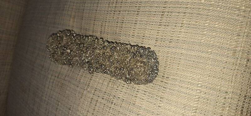

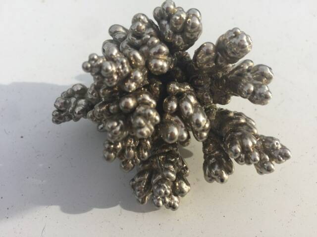

This object, about the size of a tennis ball was found by my brother. It's metal. It's very hard. Cannot scratch it with a Stanley knife. Cannot break even a small piece off using pliers. Thrown with force at concrete and undamaged. Relatively heavy. My brother estimates similar weight to lead.
Any ideas what it is, OR how to test it?

That looks like a rare lump of osmiridium or iridosmine, an alloy of osmium and iridium. If it was, it would be worth about US$400 per oz, maybe much more to a collector of mineral specimens.
https://en.wikipedia.org/wiki/Osmiridium
To identify osmiridium in the field, hit a bead with a big hammer. If the hammer head breaks, you know that it is good.
Take it to a place that has an XRF, maybe a geology department at a university, or a metal scrap recycler that sorts and supplies a local foundry.
Let us know what it turns out to be.

Can you determine the density by weighing it and determining its volume using the water displacement method? That would narrow it down pretty quickly.

Maybe chromium?
A quick Google images search suggests, if it's a natural nugget, it's likely not Osmiridum or Iridosmine - they don't seem to form bubble-like shapes:

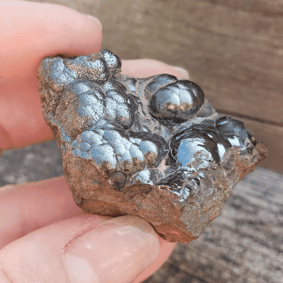

But Hematite does:
Though it's density is even less than iron.

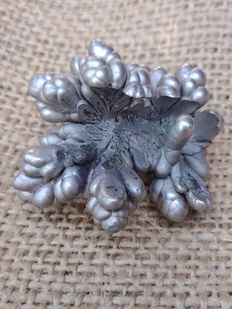

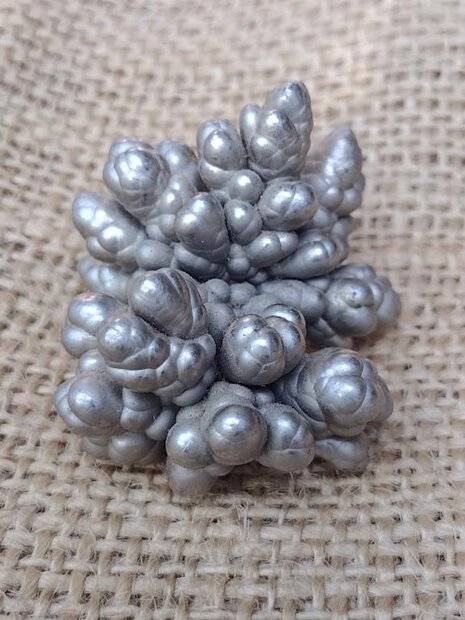

It looks a like iron formed by the Thermit process, maybe when welding railway lines or big cables.
Wouldn't it be rusty? (I honestly have no idea....)
The iron from Thermit does look exactly like the picture, but you must be correct about rust.
I'll vote for botryoidal goethite or hematite cluster. The other suggestions are much more rare than iron oxides. "When you hear hoof beats, think of horses, not zebras."
Google says hematite isn't magnetic unless heated. The iron from thermite would be. You should be able to scratch it with quartz. Also a red/brown streak test would help. There's lots of mineral id sites on the web. Here's one I picked at random. https://geology.com/minerals/hemati...tremely variable,fibrous, oolitic, and others.

"It looks like kryptonite" is all we can do from a photo. Obviously not so useful. The density, on the other hand, would tell us something. ("Similar weight to lead" is not so helpful - lead is 11, and brass is 9. Looks similar to me. And steel is 8) As would the hardness in a more quantitative way. (Steels are still an option) Maybe where it was found - just down the beach from "Billy Bob's Tungsten Emporium" would be useful to know..
@xtempore If we knew the nearest city location of the specimen now, we could arrange an XRF, which for heavy metals would be very satisfying and conclusive.
If we knew the geographic location (lat,lng) of the find from Google Earth, we could assess the geological possibilities.

Anyway, just got an update from my brother. He says it IS magnetic (as in a magnet is attracted to it).
I thought about using Archimedes test as well, but I don't have direct access to it. My brother's not very technically reminded, and I don't think he'd have an accurate scale to measure it.
From what I understand, it was near Marfell's Beach (-41.72433988098268, 174.20280210352044). To the best of my knowledge there isn't and has never been any mining around that area. There is a salt-works.
The rail-line is probably too far inland from the beach to be related.
Hoping to get access to it next time he comes for a visit!
If it is magnetic, it is likely some sort of steel slag.

Google gives back some similar pictures for 'nickel nodule'?
DaveC426913 said:
Nice likeness, but didn't we establish that nickel is too soft to resist being nicked?
I thought so too. I'm working with second-hand information from my brother. Nickel does have a Mohs hardness of 4 though. So it's about the same as steel. Give the shape of the nodules it'd be hard to really exert a good pressure with the blade, and given that they are of roughly equal hardness, maybe it's not going to be enough to scratch it noticeably.
Could the fact that this grows like a crystal mean it also has a greater degree of hardness when compared to ordinary nickel?

Electro-deposited nickel tends to have voids, so I would expect it to be softer than a crystal grown slowly.
Compounds of nickel that form on, and protect the surface, may be many times harder than the native nickel metal.
Hardened( 7) or mild steel( 4.5 )?
a jacknife blade should scratch the surface.
