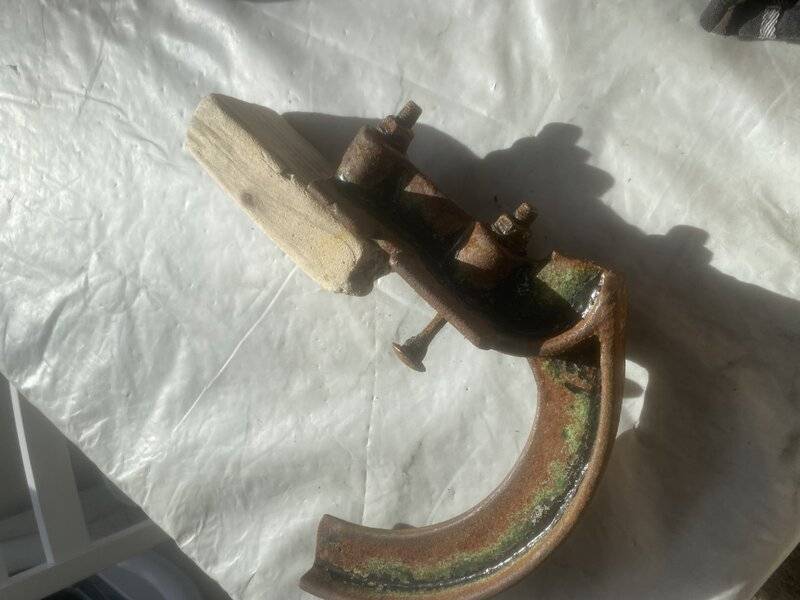

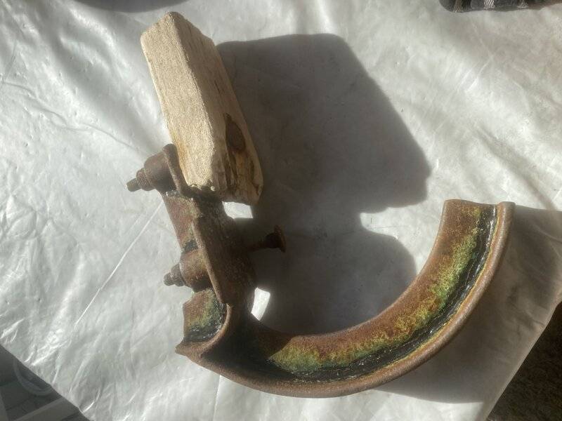

Hi apologies for intruding on your chat but I have been looking online as I have found an item on a beach /metal and wood) but haven't a clue what it is? How do I attach the picture on here?
There is an icon in the reply menu or use CTRL+P on keyboard and follw prompts
I figured it out, any advice welcome. Thankyou.
@hbs10
Welcome to PF.
That looks like part of a farm implement or cart from circa 1920.
The bolt-holes appear to be a casting, but the curved T-section would have been wrought iron. That suggests the iron part was fabricated, with welds near the casting. The two mild steel coach bolts have rusted away, faster than the wrought or cast iron material.
It might help if you could identify the Google Earth coordinates of the find.

Hi and thankyou so much for replying that's fascinating.
I've only just worked out how to access this forum again, apologies for the delay.
It was in Tenby, wales, uk
51°40'14"N 4°41'46"W. Coordinates may be slightly different but it was near the rock pools. I didn't know the family member had found it until we were back in Birmingham😞.
I was hoping to identify the item from the local agricultural history of the location, but for Tenby, that would be tourism. Maybe it was a structural part of an old donkey cart.
I expect some implement, built a century ago, was left up on the cliffs, in the bushes above the beach, and that it disintegrated, or was cut up, and fell down onto the beach.
I don't think it is part of a set of steps, or a handrail that gave access to the beach, and can't see how it could be part of barbed wire beach defences from WW2.
Take a look at the ends of the 'T' section. Was it cut with a hacksaw?
Were the 'T' sections bent during manufacture, or when the structure was demolished?

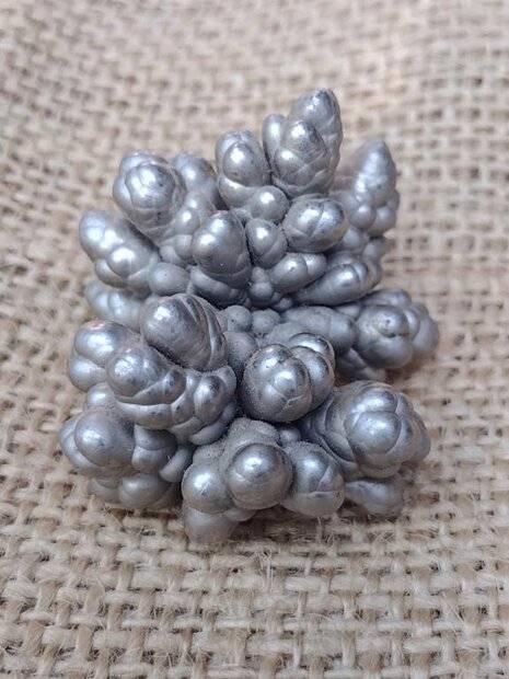

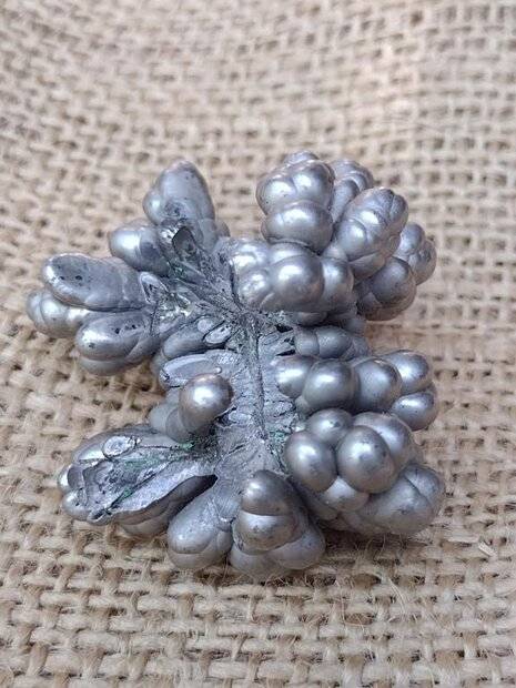

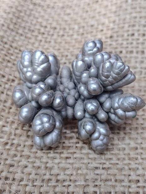

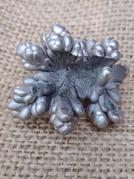

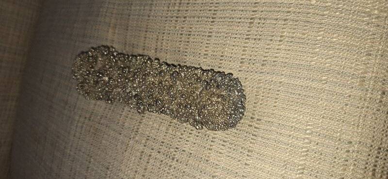

I have this unknown specimen similar to the one Xtempore has. This belonged to my deceased sister whom lived in North Central Florida. It is magnetic and weighs 89.0 grams & measures approximately 1.3/4" Long, by 1.1/2" Wide by 1.1/2" Height at the fattest side. I haven't beat on it but it feels quite hard. The center bubbles remind me of lead and the larger ones remind me more of the color of nickel. The bottom looks strange to me and little porous type holes are part of the metal.
You could determine its volume by dunking it in a full container of water and measuring how much water was displaced. With the volume and mass, you could work out the density, which will give you a clue as to its elemental composition.
or you could cheat and use Google lens to look it up and it will tell you explicitly...
Maybe it is an alloy of silver, copper, and nickel coins, melted during a house fire.
Find a big pawn broker, in a big city. They will often buy precious metals for scrap. You might claim you believe it is silver, and say you are considering selling it for scrap. They will do an XRF analysis of the heavy metal content to identify the composition before making an offer.
For example, if you are in Central Florida;
https://pawnorlando.com/gold-testing-service/
