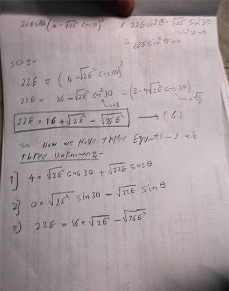

I first tried to get the third equation by eliminating the angle ##\theta##
then when trying to solve those three equations I get:
Handwritten derivation applying conservation of momentum to an elastic collision, with a scattering diagram showing incoming and outgoing particles at angles 30 and theta, and equations (1) to (4) with E4 = 4 and masses M1 = 1 and M2 = 11.
Handwritten derivation eliminating an angle from momentum conservation equations, ending in three numbered equations: 4 = sqrt(2E') cos 30 + sqrt(22E) cos theta, 0 = sqrt(2E') sin 30 - sqrt(22E) sin theta, and 22E = 16 + sqrt(2E') - sqrt(36E').
Handwritten derivation on lined paper: three momentum and energy equations, then a substitution step, ending with theta = sin^-1 of a fraction involving sqrt(2E') and sqrt(16 + sqrt(2E) - sqrt(6E')).
Handwritten notebook page showing a substitution step: a square-root expression equal to a square root of 16 plus 2E minus square root of 96E times cos of arcsin, followed by the words 'gets really complicated'. Below, on a separate sheet, handwritten 'it has to be another way'.
guys i made a little mistake the third equation in my attempt sulould be 22E=16+2E'+... not (2E')^0.5
and for the other three papers also. you will understand when trying to solve it .

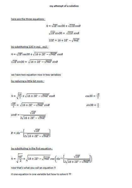

here another attempt i almost done but it stil complicated ( i had solved millions of equations ODE , PDE , vector calculus and many) but this
still got me :
Handwritten-style typed derivation titled 'my attempt of a solution' reducing three equations with sqrt(2E') and sqrt(96E') terms to a single equation in theta, ending with 4 = sqrt(6E'/2) + sqrt(16 + 2E' - sqrt(96E')) cos(sin^-1 ...).

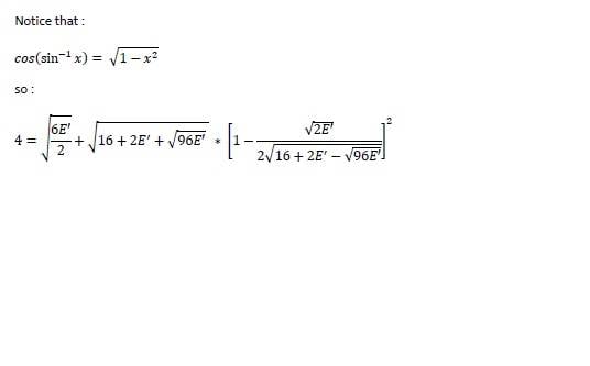

Handwritten-style typeset derivation: notice cos(sin^-1 x) = sqrt(1 - x^2), so 4 = sqrt(6E'/2 + sqrt(16 + 2E' + sqrt(96E'))) * [1 - sqrt(2E') / (2 sqrt(16 + 2E' - sqrt(96E')))]^2.
there is a lot of trigonometric identities but i don't know which one to use :
the one that i used in getting the third equation (sin^2+cos^2=1)

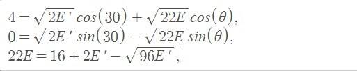

those three equation is correct i checked it :
Three equations with square roots and trigonometric terms: 4 = sqrt(2E') cos(30) + sqrt(22E) cos(θ), 0 = sqrt(2E') sin(30) − sqrt(22E) sin(θ), and 22E = 16 + 2E' − sqrt(96E').

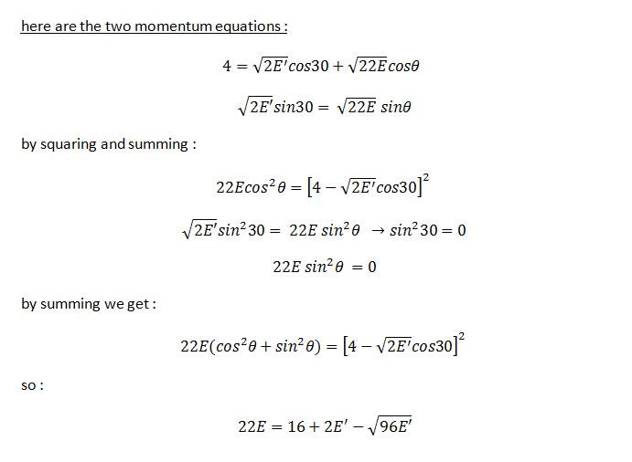

the third equation derivation i came up with my self :
Handwritten derivation of momentum conservation equations: 4 = sqrt(2E') cos30 + sqrt(22E) cos theta, sqrt(2E') sin30 = sqrt(22E) sin theta, squaring and summing to 22E = 16 + 2E' - sqrt(96E').
So it is based on the two existing momentum equations, hence it contains no new information. That means it is entirely dependent on the other two equations. The set of three equations is not a set of independent equations, and you can't use them to solve for all three variables.
You need to incorporate the Q information. You've written two momentum equations and that's all the information you can get from that. What other conservation law can you apply?

I think what the book's author actually did was use the third equation (which eliminated θ) and the energy equation above to solve for E and E'. Then θ can be found using either of the first two equations.

That's possible. I also didn't follow your derivation of that equation, as you seemed to come to the conclusion that sin(θ) was zero for reasons I couldn't see. Work with the first two equations and the Q equation.
in that case I misunderstood your issue. I thought the book had obtained the third equation from the first two and you were trying to emulate that.
So now it looks to me that your first two equations are momentum equations, and deriving the third is a good move. But now you need to combine this with an energy equation. You are given the net change in energy.
