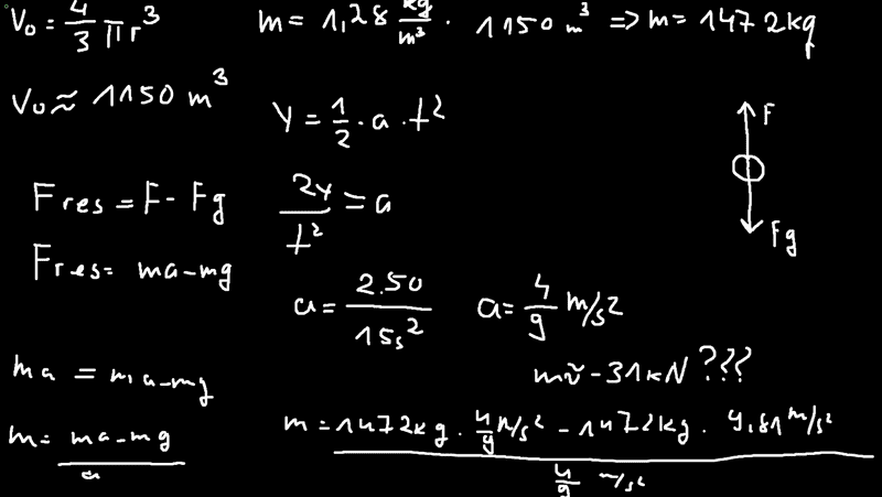

Voidness

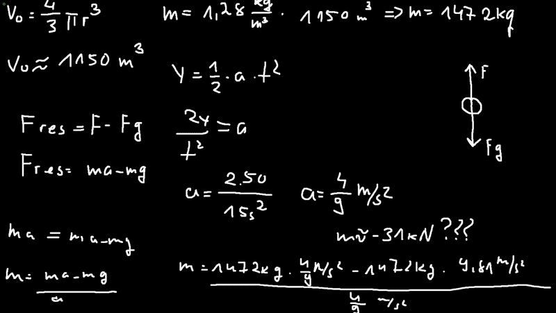

Will upload an Image
Didnt understand this but I think Force equations.
Voidness said:
Homework Statement: Will upload an Image
Relevant Equations: Didnt understand this but I think Force equations.
View attachment 360563View attachment 360561
You have shown a scattering of equations. It is hard to follow your reasoning since you have not provided that part. Let me see what I can extract from the equations.
You begin by calculating the volume of the balloon and arrive at 1150 m3.
You then multiply by the density of the displaced air to arrive at the mass of the displaced air: 1472 kg.
You go on to assert that ##F_\text{res}##, the net upward force on the balloon is given by the applied upward force ##F## minus the downward force of gravity ##F_g##.
Algebraically, this resultant force is then also given by ##F_res = ma - mg##.
You know the required acceleration ##a## is given by ##\frac{2y}{t^2}## where ##y## is the displacement that occurs (for constant acceleration starting from rest) and ##t## is the time interval over which this displacement occurs.
You evaluate ##\frac{2y}{t^2}## and get ##a=\frac{2 \times 50}{15^2} = \frac{4}{9}## m/s2.
You assert that ##ma = ma - mg##. This is erroneous. Can you see why?
You blindly perform algebra on ##ma = ma - mg##, failing to notice the obvious algebraic manipulation that would show that ##mg = 0## from which one could immediately conclude that ##m=0##.
There is an equation that looks like: ##m \approx 3.1 \text{kN}##. But that would be erroneous. The units do not work out. So I may have misread that.
At this point, things are going catastrophically down hill. You arrive at a large formula that I cannot be bothered to try to read or understand.
I consider the problem itself to be poorly set. If your approach is correct, the problem setter expects us to ignore air resistance as a sphere disturbs a volume of air that outmasses the sphere by a factor of about six to one.

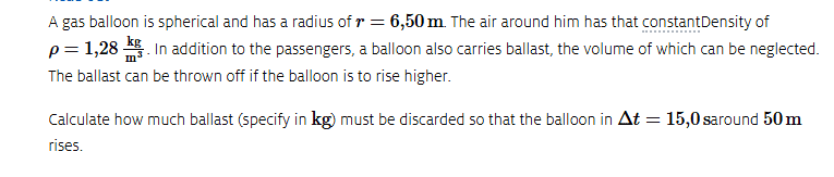

In addition to what @jbriggs444 said, the question seems incomplete:
- what is the initial mass (or weight) of the balloon+passengers+ballast?
- what is the initial state (e.g. stationary on the ground)?
If we assume/guess that the balloon is initially stationary and neutrally buoyant, both questions are answerable.
My teachers told us that when a problem appeared incomplete we were to make reasonable assumptions for the missing data, state those assumptions clearly and go on to work the exercise.
I do agree that the question should have included that background.

Sorry for this mess. I also apologize that I am bad in physics, its my first year that I have physics.
Solution are down. I dont know how to use calculus in physics, we just started calculus in math.

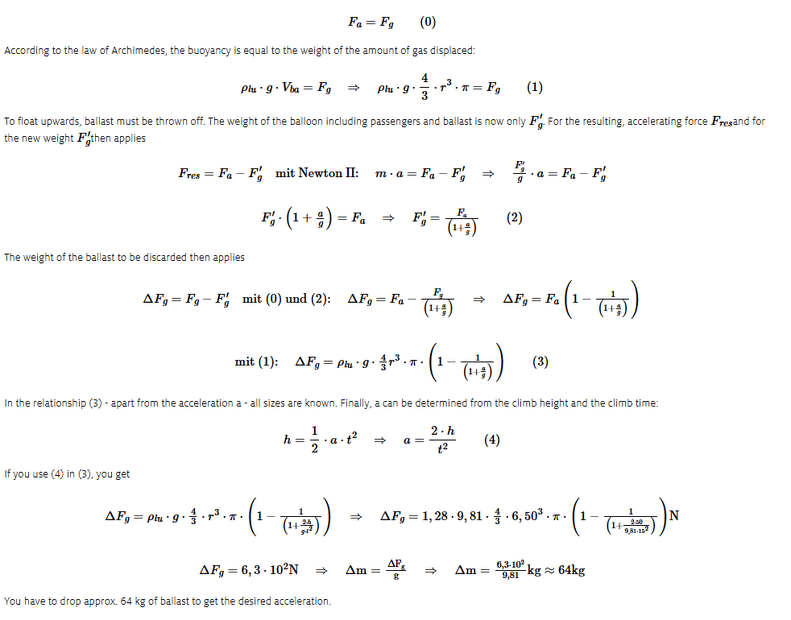

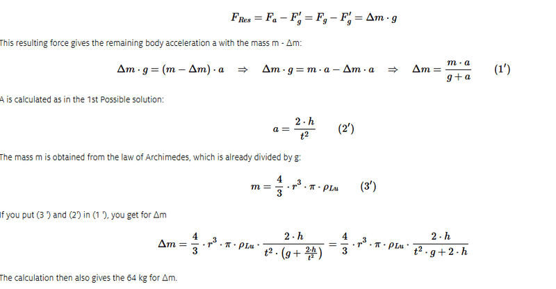

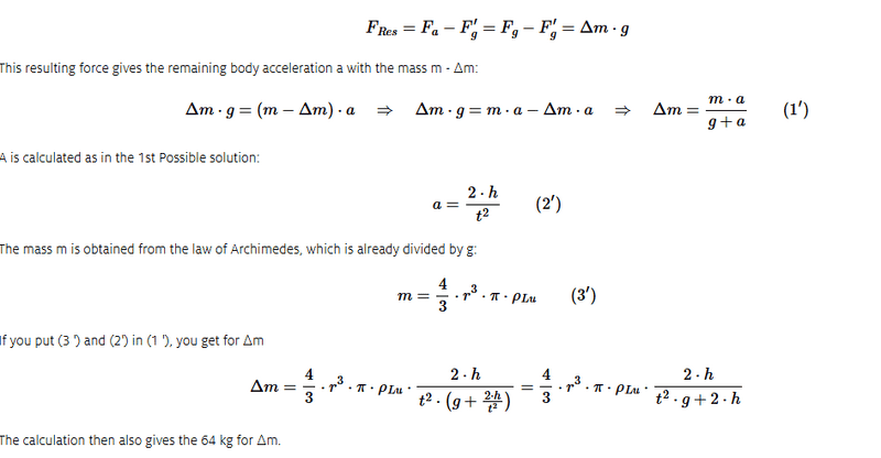

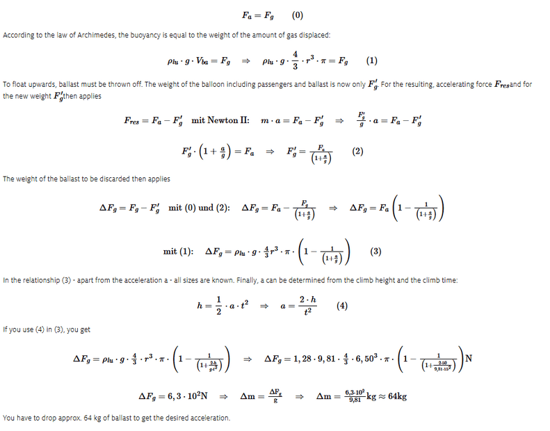

If we assume that the balloon was on the ground.
1. Solution
2. Solution
If we assume negligible air resistance, no calculus is needed for this problem.
Voidness said:
I agree with your final answer but the working is difficult (for me anyway) to follow.
It’s worth explaining the reasoning, and defining any necessary symbols, as part of your answer. If I were answering, it might be something like this...
Assume the loaded balloon (total mass ##M##) is initially at rest on the ground with neutral buoyancy. I.e. the weight (##Mg##) equals the upthrust from the displaced air (##\frac 43 \pi r^3 \rho g##) so resultant force is zero.
If a mass ##m## of ballast is removed, the new total mass is ##M-m##.
The balloon’s weight has decreased by ##mg## so the resultant force is now ##mg## upwards.
Assume negligible force of air resistance while the balloon rises.
Applying Newton II (‘F = ma’):
##mg = (M- m)a##
[a couple of lines of simple algebra]
##m = M \frac a {g+a}##
[Then calculate values for ##M## and ##a## and insert in above equation.]
