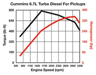

A turbocharger can work just as well on a low revs engine:
Yes, but to get power across the widest RPM band, the turbo will need to function at the low end of the revs, where it is most inefficient. As I understand it, turbocharger efficiency follows an RPM4 power, while with a positive displacement supercharger, efficiency does better than RPM2, and it follows closer to the stoichiometric air volume required.
I know the vast majority of the turbo compressed air can be dumped at the top end, but that does not relieve the requirement for a higher capacity turbocharger, that will work sufficiently well at the bottom end.
