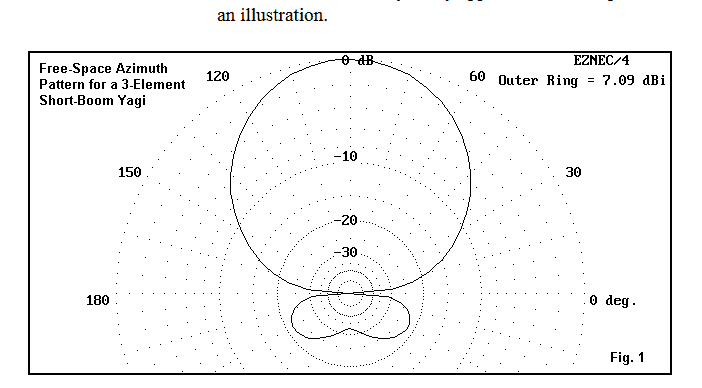

A low gain, directional antenna with a good front to back ration (say a log periodic) can deal very well with multipath. If the TV tower is very tall, feeding a large service area, the pattern can have a vertical beamwidth of only a few degrees with a bunch of bananas, off centre which is very frequency dependent. (1km away at a vertical separation of a few hundred metres is quite possible near a big mains station). A good DTV receiver could be dealing well with that but reflections from a passing car could be the last straw (and it's varying - which may not help the clever adaptive receiver to cope).

Sophie's suggestion of an antenna with a front/back ratio is mighty logical.
Here's the page i used to design my yagi
http://www.k7mem.com/Electronic_Notebook/antennas/yagi_vhf.html#Design_View
per this guy a simple 3 element yagi has a decent front/back ratio
http://www.antennex.com/w4rnl/col0300/amod25.htm
a simple straight piece of wire behind the existing antenna, called reflector
and another in front of it, called director
will turn it into a yagi of sorts
My buddy made one from pieces of lampcord taped to his ceiling,
That first link will calculate the lengths and spacing for you. A not very difficult experiment...

Very easy to make (which is a huge plus point) but the log periodic is very well behaved over the whole operating bandwidth, with an excellent FBR and only a modest gain (no surprise back lobes at some frequencies). They are frequently recommended for areas of bad multipath (a pesky block of flats just behind).
