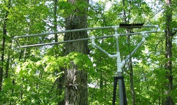

31 inch(183mhz) folded dipole, stretched to 33 inches(three halfwaves@509mhz)
business end of 509mhz yagi, exceeded expectations

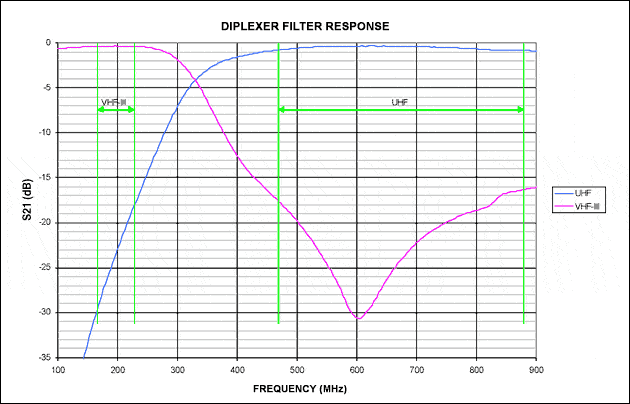

I guess i was hoping to use a piece of transmission line for a diplexer.
Google took me here
http://www.maximintegrated.com/en/app-notes/index.mvp/id/3700
and look at this
it splits frequencies when signal flow is left to right
even has a bill of materials.
if it's bidirectional it might give 20 db of separation...

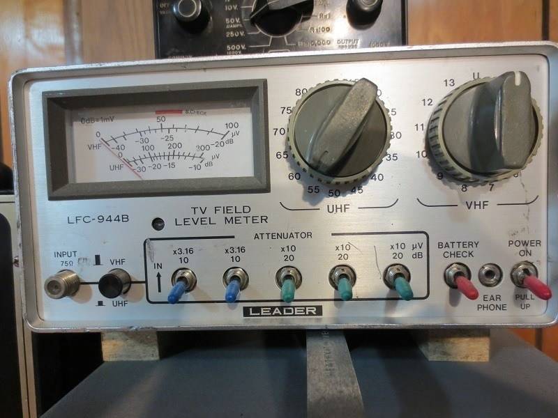

Do you have a way of measuring the field strengths? If not, I could send you this "beauty" to use for a while. :oldwink:
wow, what a treasure that is !
I'm still "getting the feel" of the TV's strength meter
so before you go to the trouble to pack it, let me see what happens in this weekend's experiments.

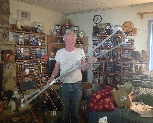

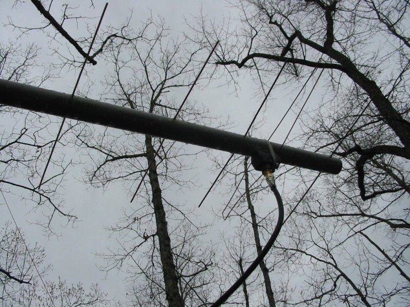

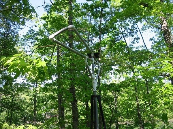

Here's two booms ten degrees apart, Yagis for 183 and 509 mhz.
( disclaimer- Fair Anne is amazingly tolerant of my cluttered corner. But she says "I just gave up" )
everything is #6 copper grounding wire (55 cents a foot)
Folded loops are paralleled at the balun
unfortunately i placed the mechanical mount near the loops where my right hand is, not at cg ~halfway between my hands.,.
But that problem only showed its head later.
here it is in the yard, in "Down Periscope" position
booms point right at the towers ~50 miles away , and each is "peaked" according to microvolt meter
Side view show it nose-heavy as you'd expect
my "Plumber's Nightmare transfers the bending moment from 3/4 to 1.5 inch PVC and it seems sturdy enough.
It feels a lot more stout than it looks.
Quite rigid actually. It's the skew of the booms gives optical illusion of bent.
