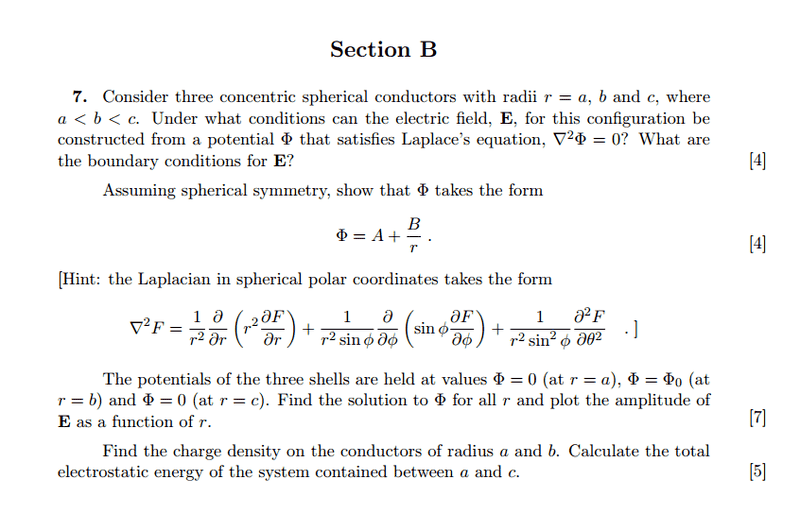

Consider three concentric conducting shells, with potentials [tex]0, ø_0, 0[/tex] and radius [tex]a, b ,c[/tex] where [tex]a < b < c[/tex].
(a)State conditions for Laplace to work and boundary conditions for E
(b)Show ø is of the form:
(c) Find ø and E everywhere.
(d) Find the charge density and electrostatic energy.

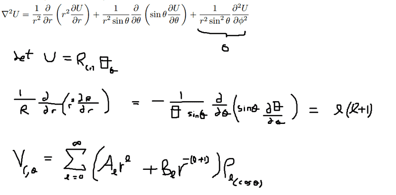

Part (b)
Consider [tex]r → \infty , V → const.[/tex]
[tex]\sum_{l=0}^{\infty} (A_l r^l)P_{l cosθ} → const.[/tex]
This implies that [tex]l = 0[/tex] is the only solution.
Thus, general solution for ø:
[tex]ø = A + \frac {B}{r}[/tex]
