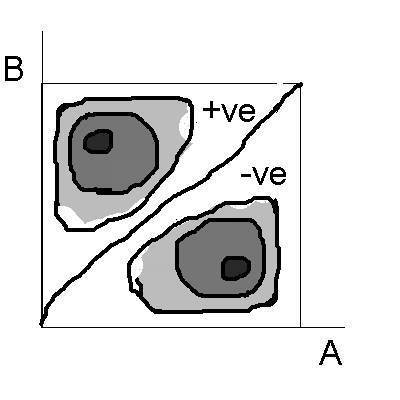

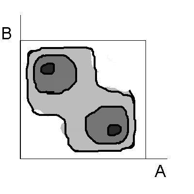

This question came up in another thread I started about the wave functions of helium vs hydrogen. It's gone off on something of a tangent so I hope I'm not out of line in starting a fresh thread with this topic.
I've basically sketched what I would think are the only two realistic candidate solutions for two electrons in a potential well. I basically looked for the simplest solution where the electrons made some kind of effort to stay away from each other and wrote it out as a simple product function. Since the product function wasn't symmetric, I reversed the two electrons and added the two functions together. Standard symmetrization. Then I noticed that the anti-symmetric combination looked like it might have lower energy, in this case, than the symmetric combination. So I've got these two wave functions and I can't see any obvious way to tell which would be the correct ground state.
I also haven't figured out if the spin states have a significant effect on the energy. Of course the symmetric combination would have the singlet spin state and the other combination would have the triplet state. I just don't know if I have to worry about that yet.
I posted my sketches in the other thread. I don't know how to make the thumbnails appear below so I'm just going to put these links in and see if they work. I hope the meaning of the diagrams is obvious:
SYMMETRIC FUNCTION:
https://www.physicsforums.com/attachment.php?attachmentid=24045&d=1267583181
ANTISYMMETRIC FUNCTION:
https://www.physicsforums.com/attachment.php?attachmentid=24046&d=1267585014

Now, if you consider turning on weak repulsive interactions:
State A will still be the lowest energy, but the circular blob will distort so that it begins to look like what you have called 'SYMMETRIC FUNCTION'. It must be symmetric, because the spin part is antisymmetric.
The 3 State Bs will be the next energy level. B is lower than C because the repulsive energy of interaction between the electrons is automatically smaller in the antisymmetrised spatial wave function state than the symmetrised spatial wave function state.
State B will begin to look like you 'ANTI-SYMMETRISED' state.
If the repulsive interaction is sufficiently strong, the levels might begin to cross and it won't be easy to make statements like the above.
