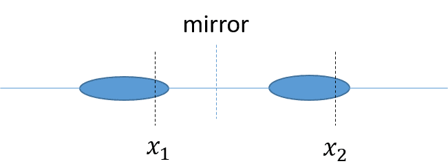

Suppose that we have a system including two single (and identical) orbitals as shown in the attached image. Then, consider the states that we have two different spins on the two orbitals. It seems that because of the left right symmetry of the system the special part of the wave function can not be asymmetric and so we can not have triplet (symmetric) spin wave function and only the singlet state is permitted. I would like to know if this reasoning is correct. Any help is appreciated.

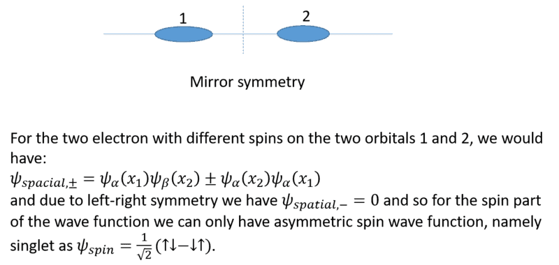

If you stipulate that the two electron spins must have opposite values (i.e., total spin zero), that already rules out two of the three triplet states. But on what grounds are you making this stipulation?
I assume you mean "spatial" (not "special"). It is not correct that left right symmetry of the system (meaning its Hamiltonian) requires that the spatial wave function must be symmetric. You can have spatially asymmetric wave functions in this case; they will just occur in pairs, with each one of a pair being the mirror image of the other.
The opposite spins does't necessarily mean that the total spin is zero. We can also have the state $$\frac{1}{\sqrt(2)}(\uparrow \downarrow+\downarrow \uparrow)$$.
Right, sorry for typo. Could you please write the asymmetric spatial wavefunction in this case?
You wrote one possibility already (although it has an index error in it, which I'll correct), the "minus" part of your spatial ##\psi## wave function:
\psi_\text{spatial} = \psi_\alpha (x_1) \psi_\beta (x_2) - \psi_\alpha(x_2) \psi_\beta (x_1)
This is antisymmetric, so it's one wave function of a pair that are mirror images of each other. The other is what you get if you swap ##x_1## and ##x_2##.

Alright, this wave function is zero because of symmetry and so we only have the symmetric spatial wave function (with singlet spin wave).
Why? As I've already said, left-right symmetry does not mean the spatial wave function has to be symmetric. It just means that antisymmetric wave functions have to occur in pairs, with each one the left-right mirror image of the other. There is nothing physically impossible about the antisymmetric spatial wave functions; they just imply that if the electrons are in that spatial state, their spin wave function must be symmetric.
I suspect that what you are actually trying to find is the ground state, i.e., the state of lowest energy, for this system. But if so, you should state that explicitly, because finding the ground state is a much more restrictive problem than just finding states that can have nonzero probability in general.

I pointed that we are talking about the specific case which two electrons with opposite spins are on two orbitals.
In this case, because of symmetry we have $x_1=-x_2$ and $\alpha=\beta$ and we can infer that the spatial part is zero.
Yes. So what?
No, we don't. The fact that the electrons are in the left and right orbitals does not mean their ##x## coordinates must satisfy this relation. The orbitals are not points.
hokhani said:
and $\alpha=\beta$
This makes no sense. ##\alpha## and ##\beta## are labeling the two electrons. They can't both be the same electron.

I attached a non-symmetric configuration of electrons in the orbital in the mirror-symmetric system. Do you mean that we can have such an electronic position?
You are misunderstanding my point. Even in the "symmetric" configuration of orbitals you originally drew, the fact that electron 1 is in the left orbital while electron 2 is in the right orbital does not mean that ##x_1 = - x_2##. The orbitals are not points, they are regions of space, so they don't correspond to just one value of ##x##.

My reasoning is based on the mirror symmetry of the system. In the figure, I sent in my previous post, could you please explain the possibility of having instantly the two electrons in the non symmetric configuration while the system is symmetric?
The fact that "the system is symmetric" does not mean the exact electron positions have to be symmetric all the time. "The system is symmetric" just means that the Hamiltonian of the system is invariant under parity inversion about the "mirror" surface shown in your drawings.
In fact, saying that one electron is in the left orbital and one electron is in the right orbital does not imply a definite position (value of ##x##) for either electron at all. The orbitals, as I have already pointed out, are not delta functions. So the whole way you are writing down the spatial wave functions is not really correct to begin with.
