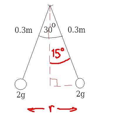

Two identical, small spheres of mass 2.0g are fastened to the ends of a 0.6m long light, flexible, insulating fishline. The fishline is suspended by a hook in the ceiling at it's exact center. The spheres are each given the same electric charge. They are in static equilibrium, creating an angle of 30° between the halves of the string. Calculate the magnitude of the charge on each sphere.
Here's a sketch of the picture given on the worksheet:
Red lines are what I drew over the diagram to make a right triangle.
This being a bonus type question, I was given three possible answers and had to find out which one was the real one:
q =
3.7 x 10^-7 C or
1.2 x 10^3 C or
1.2 x 10^-3 C.
Coulombs Law: F = k \ \frac{q_1 q_2}{r^2}
First I converted the mass into kilograms: m = 0.002kg
Then I split the angle into two right triangles to get the distance between the spheres.
r/2 = Sin15 x 0.3 m
r = approx. 0.16m
Then I figured since the spheres are at rest, then a = 0 and Fg = Fe...so I tried coulombs law to solve for q:
F_{g} = F_{e}
mg = k \ \frac{q_1 q_2}{r^2}
\frac{mgr^2}{k} = q_1 q_2
I ended up with 2.6 x 10^-11...obviously way off any of the true answers.
Thanks for taking the time to read over all this. =D
Cheers - Krunklehorn
You need to look at the forces acting on the balls.
There is a vertical force = weight of a ball = 2x10^-3x9.81 = 0.0196N
There is a sideways force, F, due to the repulsion.
Can you see that F/0.0196 = Tan15
This will give you F to use in the repulsion equation.
I got Q = 1.2x10^-7C, on your list there is 1.2x10^-3C
I use k = 8.98x10^9 in the repulsion equation

Oh I see! Fe pushes the spheres to the side while Fg pushes them down to the ground.
Tan = Opp / Adj so my equation should be:
Tan15 Fg = Fe
\frac{Tan15mgr^2}{2k} = q
Awww too bad it's actually wrong. I am getting 7.03x10^-15 as an answer.
Agree with technician. The force on one of the spheres is equal to the x-component of the fishline force(S):
Sx=S*sin15
and
S=Sy/cos15
Therefore
q=1.19*10-7
since
Fe=m*g*tan15

Oh I completely agree with him and appreciate the help immensely...I just don't see why I'm getting such a mangled answer.
Did I rearrange the equation wrong?
The equation
Fe=(k*q2)/(r2)
can(as you know) be rewritten as
q=r*Sqrt[Fe/k]
Sum of forces in x-direction equals zero:
Fe-Sx=0
therefore
Fe=Sx
Similarly in the y-direction:
Sy-w=0
therefore
Sy=w=m*g
Now, from simple trigonometry you see that
Sy=S*cos15
and
Sx=S*sin15
This means that you can write Sx as
Sx=(Sy/cos15)*sin15=m*g*tan15
And from the equilibrium equation in the x-direction you see that
Fe=m*g*tan15
Now you have Fe. You then need the distance r between the spheres:
r=2*0.3*sin15
Filling all this information into the expression for q then gives you
q=1.187*10-7 C
