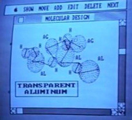

There appear to be lots of ways to make transparent aluminum.
The Trekkian formulation was: Ag2H6Al3
Star Trek IV: The Voyage Home
t = 1:59
TM & © Paramount (1986)
