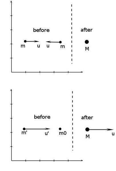

I am reading Resnick and Halliday's "Basic Concepts in Relativity" (ISBN: 0023993456) and have come to an impass about deriving equation 3-4a
\begin{equation}m = \gamma m_0\end{equation}
in the text. The authors wrote that the equation can be derived from the following equations
\begin{array}{cr}
M = m^{\prime} + m_0 & \\
Mu = m^{\prime} u^{\prime} & \\
u^{\prime} = 2u / (1+u^2/c^2)& \\
\end{array}
based on the attached figure. The derivation is left as an exercise (problem 18 pp 133). The problem is to derive m in the first equation above from the three equations below it, but I only keep coming up with
\begin{equation} \frac{m^{\prime}}{m_0} = \frac{1+u^2/c^2}{1-u^2/c^2} \end{equation}
which is an intermediate equation in Tolman's text that leads to the desired equation after substituting a transformation equation for γ into the rhs ratio (e.g. see the sometimes "colorful" thread at https://www.physicsforums.com/forumdisplay.php?f=70\&order=desc\&page=23). But this approach seems to deviate far afield of the three equations given, and it leaves me feeling like I am doing something wrong. What I mean is that I cannot complete the derivation without including the transformation for γ from Tolman, and it seems to me that the authors think I should. Can anyone tell me what I am doing wrong? Hints, recommendations, anything? I am stuck. Apparently the book is out of print, so I can provide more info if need be. Thnx for any help.

Okay, after fixing my interpretation of the m's, here's a re-do of my previous (now deleted) post:
I don't agree with the first two of the three equations you wrote down that you say you're supposed to derive the result from. When I write down energy and momentum conservation in the two frames, here's what I get (I'm using units where c = 1, and the first and second values given for E and p in each frame are before and after the collision):
Unprimed Frame
[tex]E = 2 m = M[/tex]
[tex]p = 0 = 0[/tex]
Primed Frame
[tex]E' = m' + m_0 = \gamma M[/tex]
[tex]p' = m' u' = \gamma M u[/tex]
where [itex]\gamma = 1 / \sqrt{1 - u^2}[/itex] has to be included on the RHS of the primed frame formulas because the single object with rest mass [itex]M[/itex] is *moving* in that frame.
If you start with the above equations (and your third equation for [itex]u'[/itex]) and eliminate [itex]m'[/itex] and [itex]u'[/itex], you should be able to easily derive [itex]m = \gamma m_0[/itex]. I would suggest checking the textbook to make sure you haven't left out a gamma factor in the two equations involving [itex]M[/itex].

As PeterDonis noted, the figure from the text has a misprint: the M in the upper right of the figure should have a supscript o because the mass is at rest: ##M_o##.
You can use the figure to derive the explicit expression for ##\gamma## if you assume that relativistic mass and rest mass are related by ##m = \gamma m_o## where the explicit form of ##\gamma## is yet to be determined.
The upper part of the figure gives:
##2m = M_o## [itex]\;\;\;\;\;\;\;\;\;\;\;\;\;\;[/itex] (1)
And the lower part of the figure gives:
##m’ + m_o = M## ##\;\;\;\;\;\;\;\;## (2) ##m'u' = Mu## ##\;\;\;\;\;\;\;\;\;\;\;## (3) Using ##u’ = 2u/(1+u^2/c^2)## and eliminating ##m'## between (2) and (3) yields
##(1-u^2/c^2)M = 2m_o\;\;\;\;## or ##\;\;\;\;(1-u^2/c^2)\gamma M_0 = 2m_o##
Using (1) to replace ##M_o## by ##2m = 2\gamma m_o## yields
##(1-u^2/c^2)\gamma ^2 2m_o = 2m_o## .
Thus, get the desired result: ##\gamma = 1/\sqrt{1-u^2/c^2}##.
[I believe this is essentially the derivation that PeterDonis outlined]

PeterDonis: Your comment that you don't agree with the given equations caught my attention because it crossed my mind if there was a typo among them. But I have double checked and triple checked the text (first thing I do when I am stumped) and the figure and equations are as they appear in the text.
bcrowell: I cut my teeth on the H & R "Fundamentals of Physics" text and liked another text they wrote (a sophmore/junior level QM text), but this relativity text really is truly awful; I came to it seeking a more elegeant derivation than that in Tolman's text.
TSny: Your statement "... where the explicit form of γ is yet to be determined." was my "aha" moment as that is how I derived γ for the LT's earlier in my studies.
Yes then, the typo is certainly in the figure in which M is ambiguous and left as such in the narrative (and caption). Thnx loads for your help folks; I understand this now.

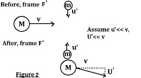

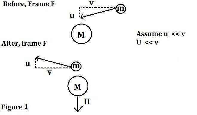

Let's assume that momentum has the form:
[itex]\vec{p} = F(v) m \vec{v}[/itex]​
where [itex]F(v)[/itex] depends on the magnitude of [itex]v[/itex], not its direction.
To have the right nonrelativistic limit, it must be that [itex]F(0) = 1[/itex]
Now, consider a collision in which in frame [itex]F[/itex] a very light particle of mass [itex]m[/itex] is moving relativistically with a horizontal component of velocity of [itex]v[/itex] and a very small vertical component of velocity [itex]u[/itex]. The magnitude of the velocity is [itex]\sqrt{v^2 + u^2} \approx v[/itex].
This lighter particle "bounces" off a much more massive particle of mass [itex]M[/itex] initially at rest in frame [itex]F[/itex] imparting a small vertical component of velocity [itex]U[/itex] to the larger mass. The "Before" and "After" pictures are shown in Figure 1:
I'm going to leave off the detailed argument, but approximately what will happen is that for the light particle, its vertical component of velocity will just flip signs, and its horizontal component of velocity will remain unchanged.
Conservation of momentum in frame [itex]F[/itex] implies:
[itex]- F(v) m u = +F(v) m u - MU[/itex]​
So
[itex]MU = (2 m u)F(v)[/itex]​
where I used the nonrelativistic form of momentum for the massive particle. Now, look at the same collision in a frame [itex]F'[/itex] in which the lighter particle initially has no horizontal component of its velocity. The collision in this frame looks like Figure 2:
I'm going to skip the derivation, but the Lorentz transformations can be used to show that in frame [itex]F'[/itex] the vertical components of velocity for the two particles are related to those in frame [itex]F[/itex] by:
[itex]u' = \gamma u[/itex]​
[itex]U' = U/\gamma[/itex]​
where [itex]\gamma = 1/\sqrt{1-v^2/c^2}[/itex] as usual.
Conservation of vertical momentum in frame [itex]F'[/itex] gives us:
[itex]-m u' = + m u' - F(v) M U'[/itex]​
So
[itex]2m u' = F(v) M U'[/itex]​
Rewriting in terms of [itex]u[/itex] and [itex]U[/itex] gives:
[itex]2m u \gamma = F(v) M U/\gamma[/itex]​
Substituting the previously derived value for [itex]MU[/itex] gives:
[itex]2m u \gamma = F(v)^2 (2mu)/\gamma[/itex]​
So
[itex]F(v) = \gamma[/itex]​
So we have the relativistic form of momentum:
[itex]\vec{p} = \gamma m \vec{v}[/itex]​
