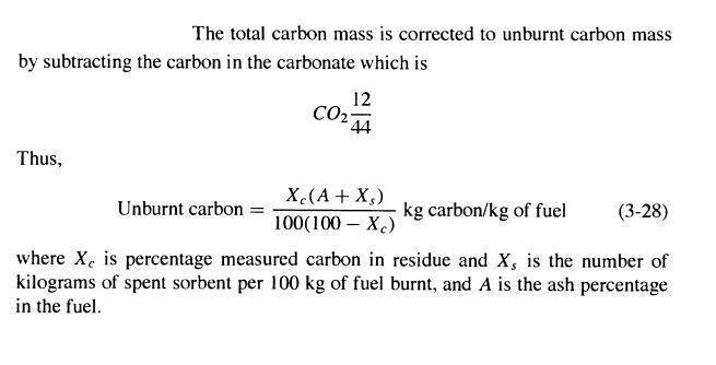

Hi there,
Hope you all are doing good.
I was reading a book on boilers and burners design and had a problem in understanding some part of the text which I have attached below
The problem is I not comprehend that
1. How unburnt carbon mass can be achieved by subtracting CO2 * 12/44
2. The units of the second picture are not being achieved.
If anyone can help me in this regard, i would be very glad.
Thanks in advance.
I forgot to attach the file... please see it here
Scanned textbook page with text explaining that carbon in carbonate is subtracted from total carbon mass using CO2 with factor 12/44, followed by equation 3-28 for unburnt carbon in kg carbon per kg of fuel.
Answer 1. What is the atomic/molecular mass of carbon, oxygen and carbon dioxide?
Answer2. There is no second picture . If you mean equation 3-28 why do you think units are not correct?
Hey hello 256 bits. thanks for help.
I did a quick calculation of the first question and I got the answers.
I did the solution like this
C_total = C_burnt + C_unburnt
C_unburnt = C_total - C_burnt
As the C_burnt forms CO2, therefore C_burnt = 12/44*CO2
C_unburnt = C_total - 12/44*CO2
As for the second question, yes I am talking about 3-28. I reattempted the solution, but could not get the balanced units. Any help in this regard is highly appreciated.
