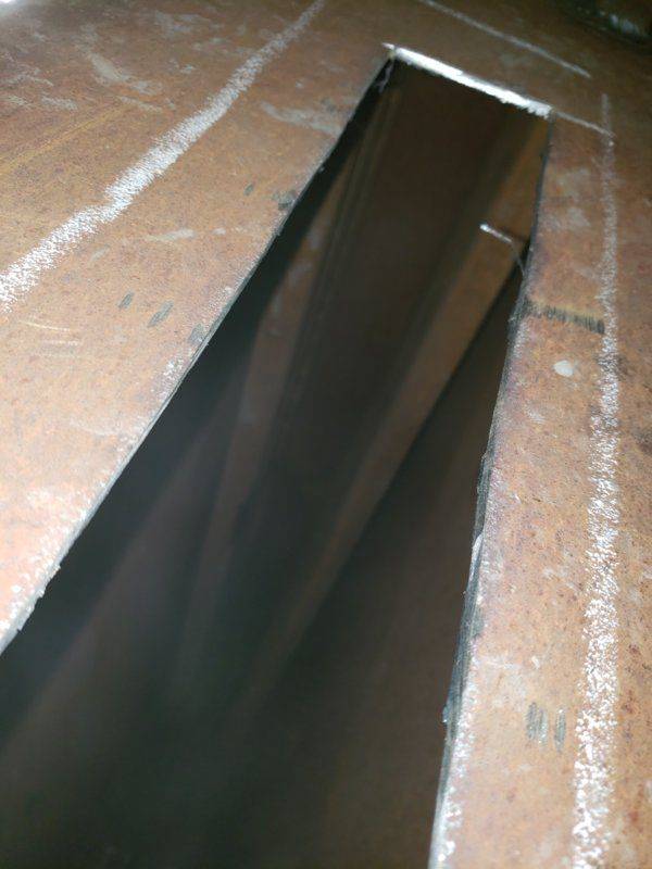

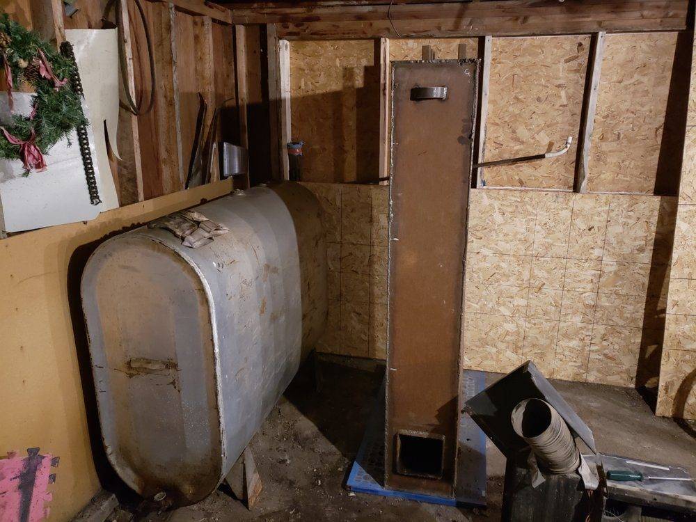

So, that is when I decided to build a boiler of sorts. It is a metal box , 12 inches wide, 42 inches deep, and 72 inches high.

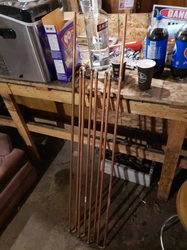

Near the bottom the fire box sits, it it 8x8 inches and reaches from front to back. It has 6 x 1.5x1.5 square tubing flues welded into the back which extend to the top, for heating the fluid from the exhaust. I plan to fill the boiler with oil, so I heat oil, then a copper heat exchanger hangs inside the tank for water to pump through. This way I don't worry about water rotting the tank out.
What I'm wondering about, as I swap the oil burner assembly from furnace to boiler, the furnace 5 inch chimney vent has about 20 square inches of cross section, while the 6 flues of the boiler only add up to about 10 square inches cross section.
Because the fire box in boiler and flues are surrounded by liquid, the combustion gasses may cool off a lot faster than the furnace. May.
So in this case, it seems I may need to do something to increase air flow 🤔.
The burner combustion fan uses about 34 cubic feet per minute of air. If this boiler causes flow restrictions, the little fan might not be enough.

So far I think this is the best idea to push extra air into the combustion. I can easily build a box around the burner assembly, and i found a kitchen range centrifugal blower that is rated for 80 cubic feet per minute.

The metal used in this boiler is 1/8 inch plate, the flues are 1/8 inch wall, and fire box is 1/4 inch thick. So it it pretty heavy built.
As for safety devices, the burner assembly has an optical flame sensor so if the flame goes out, it will shut off and need manual reset to start again.
I am going to use 3 digital thermostats to control the burner on/off cycles. 2 will be wired in series so that they both will be set to turn on at 180*f and off at 200*f . This way if one were to fail, the burner wouldn't keep running and overheat.
The 3rd sensor will be in the exhaust collector (which I haven't made yet) to measure the exhaust temperature so it will shut off if the exhaust is too hot.
I think between these 3 sensors it should be impossible for an overheat situation that can start a fire or cause oil to start vaporizing in the tank.
The hole in the top of the tank I have a plate that fits over, and I will drill holes for the heat exchanger so it sits inside tank in the hot oil. Also I will put a 2 inch fill line on it which will route outside for fumes to vent when the oil gets hot.
I will use engine high temp gasket maker to seal this plate to the top of the boiler.
The fire box and flues were leak tested before welding the box around, but the box has about 5 or 6 pinhole leaks that need fixing. I tried filling the tank with water but then I couldn't weld over the leaks. So next I will try pumping air in and finding leaks with soap spray and welding. Also I got a metal punch to punch the pinhole before welding.

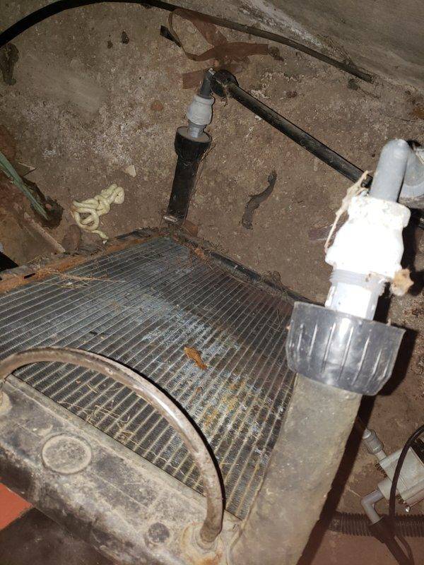

Once this is running and the oil is hot, I have 120 feet of insulated 1/2 inch hoses running to house where there is a radiator and water pump. So in the house I will have a thermostat and when it gets cold enough, the fan will turn on and blow through the rad, and the water pump will turn on and circulate water to the boiler in garage through the copper sitting in the hot oil in the boiler tank. I'm excited to get it all working.

This is the pump I have
https://www.amazon.com/dp/B0002APPBM/?tag=pfamazon01-20It seems to pump pretty decent, I've pumped through the 2 way 120 ft length and it seems to flow pretty good.
The pump is only good for 150*f anx the system may be closer to 200*f but the pump will be after the radiator in the house so it shouldn't be an issue.
The radiator is just a car radiator adapted down to 1/2 inch fittings. I know it ain't pretty but it should work.
