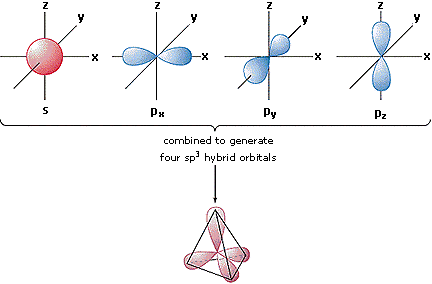

Describing molecular geometry using the Valence Bond Theory uses the same basic Parent Structures but describes the geometry in terms of 'Hybridized Valence Orbitals'. That is, the valence shell of the ground state electron configuration of the central element must undergo change in order to accommodate the Bonded and Non-Bonded electron pairs associated with the central element of the binary molecule. Applied to water, begin with the electron configuration of Oxygen =>
O: [He}2s22px2py1pz1. The valence shell of Oxygen can not accommodate bonding in this configuration because of energy differences between the valence shell sub-orbitals. So, the valence orbitals blend together to generate 4 equal energy 'Hybridized Orbitals' made from 1 s-orbital and 3 p-orbitals. Each of the 4 hybrid orbitals are termed sp3 hybrids b/c they are formed by blending 1s and 3p orbitals. Each is an asymmetric figure 8.
Four of the hybrids (green) will join at the apex origin and assume positions in 3D space that minimize repulsion energy. Two of the hybrids have paramagnetic electrons (i.e., a single electron) and two have diamagnetic electrons (i.e., Non-Bonded electron pairs). The Hydrogen 1s1 orbitals pair with the paramagnetic electrons to form two Bonded pair and a Bent Angular Geometry.
Two of the hybrids contain diamagnetic electron pairs ( = Non-Bonded Prs ) while the two with paramagnetic electrons bond by paring with the 1s electron in each of the Hydrogen atoms.
Now, one thing you need to understand about this is, the hybrids are 'pre-bonding' conditions. Once the H bonds to the Oxygen the bond becomes a 'Sigma Bond'. Which is defined by the fact that a line of symmetry can be drawn through the nuclei of the bonding elements. This means that water has two sp3 hybrids with Non-Bonded Diamagnetic electrons and two Sigma bonds accommodating the Hydrogen to Oxygen Bonded Pair.
The H - O bonds are Sigma Bonds and the Non-Bonded Pr are in sp3 hybrids. Try this with CH4 and NH3. Methane has 4 Sigma Bonds from H-C bonds and zero Non-Bonded Pr => geometry = Tetrahedron. Ammonia has 3 Sigma Bonds and 1 sp3 hybrid with 1 Non-Bonded Pr => geometry = Pyramidal. Remember, geometries are defined only in terms of bonded pairs. Also, geometries are equivalent to those derived in the VSEPR Theory. :-)
