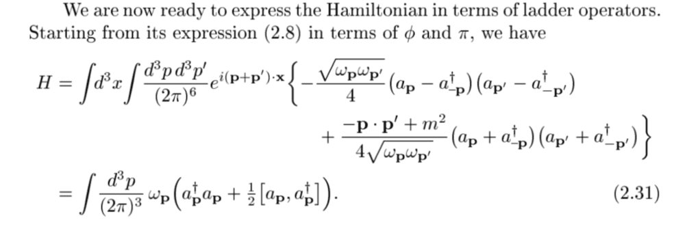

I was wondering how to deal with this step in Peskin and Schroeder:
So first you make the delta fn. from the exponential as d(p - (- p')), then what do you do with the creation/annihilation operators that have a negative subscript? I don't have to go into position/momentum representation do I?..
You just do the integrals. Of course you integrate over ##\vec{x}## first. Then the integral over ##\vec{p}'## is trivial. Finally you use the commutation relations.
Note that (2.31) is a non-sensical expression and think about, why you can simply erase the nonsensical part ;-))).

This is the first time where the sloppy math of us physicists hits back in QFT: The commutator is a nonsensical result since it's proportional with ##\delta^{(3)}(0)## (which hand-wavingly argued is alread infinite), which then is even made "more infinite" by integrating over ##\omega_{\vec{p}}##.
The cure is very simple: As long as you do not refer to gravity the absolute value of energy doesn't matter since only energy differences are observable. All you want is a definition of the free-field Hamiltonian, which represents energy and the time evolution of the field operators (and any operators representing observables built from them) in the interaction picture. Thus you can simply through the non-sensical term away, because it's "an infinite operator proportional to the unit operator". Then you are left with a well-defined free Hamiltonian.
Now you can check that this "renormalized" free Hamiltonian satisfies the properties it should, i.e., that it leads to a useful time evolution for the field operators and observables.
Ok, I did those two integrals, then factor out the ##\omega_p## and foil out the c/a operators to get
$$ \frac{1}{2}(a_p a_p^\dagger + a_{-p}a_{-p}^{\dagger}) $$
I see how this is equivalent to the final expression if -p = p, but how do you deal with those negative momenta? Can you just flip them to positive without worrying because of some symmetry?
Yes because the energies are even functions of the momenta and the minus signs between the differentials and the integral limits cancel.

Thanks! So do you mean that the limits of integration are ##(-\infty , \infty)## which could just as well be ##(\infty, -\infty) ##?
Just substitute ##\vec{p}'=-\vec{p}## in the second integral.
