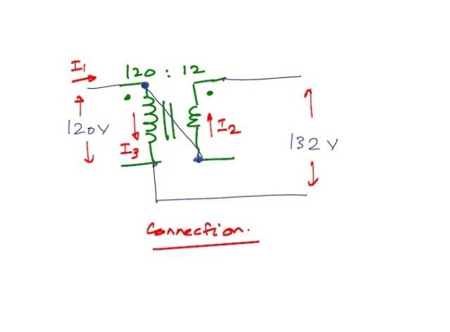

I tried doing the question like a normal transformer, but the result I got was vastly different from my teacher's. I also don't understand how my teacher could add 12V to the primary voltage of 120V to get 132V as the answer. I also don't understand a diagram he drew for the auto-transformer. Does anyone understand what this diagram mean?

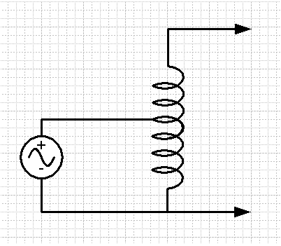

Essentially an auto-transformer is a single coil with a "tap" along its length which divides it into two sections (or two coils if you will). The two sections are inductively mutually coupled.
You teacher took an ordinary two-coil transformer and connected its wires to form the equivalent of an auto-transformer.

I see. Thank you. :) I am puzzled why the voltage of the secondary side can be higher than that of the primary side as the "main" transformer has turn ratios 120:12. I am also unable to see how the figure my teacher drew is related to the diagram you have shown above as they look quite different, although I know that your diagram is correct. ><

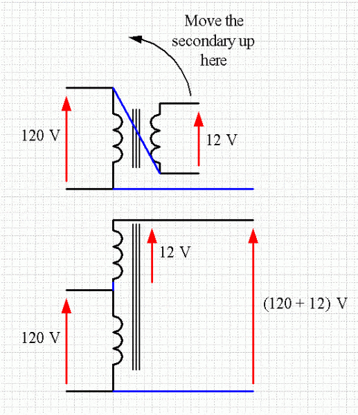

By making the connection shown, you're just "stacking" the secondary on top of the primary. The flux linkage still induces the same voltage on the secondary, but now it is added to the potential at the top of the primary due to where the secondary and primary conductors are connected.

OHHHHHH! This is awesome! I can totally understand it now! Thanks! :D:D You save my life! I'm going to have my exams in a few weeks' time and this autotransformer thing has been a bit abstract to me as it is rather new. Haha.

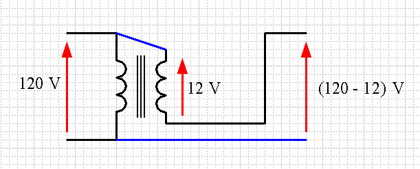

Just to confirm, if I were to draw the diagonal line the way other way (i.e. from bottom left to top-right), will the above setup become a step down autotransformer?

Not quite. Connect the tops of the windings (see figure). You can imagine the primary and secondary as having their labeled voltages and connect their wires accordingly to reinforce or oppose each other.
