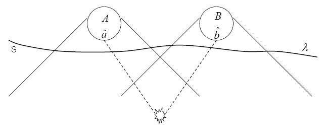

  • #31
JesseM said:
And what if H represents all local physical facts in the past light cones of the regions where measurement results A and B occurred, at some moment after the time when the two past light cones stopped overlapping (as depicted in Fig. 4 here)? In this case, if you want to know the probability that setting b will give measurement result B over here, and meanwhile another measurement is being made far away with setting a, then if you already know H, the full information about all local physical variables in the past light cone of the measurement b at some time after the last moment when the past light cones of a and b overlapped (so that nothing in H can have a causal effect on the outcome at a), then learning that measurement a resulted in outcome A should tell you nothing further about the probability that measurement b will result in outcome B.
Here's how I'm thinking about it:
The information regarding whether A or B will detect isn't known at the outset (this knowledge isn't in the past light cones of A and B). So, at the outset of any given trial, the probability of detection at A and the probability of detection at B is always just .5 (even for EPR settings).
On the other hand, what is in the past light cones of A and B is the experimental preparation and setup, which allows that if we've agreed to use the EPR setting, |a-b| = 0, then if A registers a detection, then the probability of detection at B (which was .5) at the outset of the trial, is thereby altered to 1.
So, wrt any settings that allow such contingent alterations in the the probability of an individual detection then F(B|AbH) /= F(B|bH) and F(A|BaH) /= F(A|aH) and F(AB|abH) /= F(A|aH) F(B|bH).
But this doesn't imply ftl because the contingencies that alter the prediction at B given a detection at A, and vice versa, are facts of the experimental setup in the past light cones of both A and B.
Am I missing something?

  • #33
zonde said:
Sounds like PBS based analyzer with two detectors. So it's fine.
OK.
zonde said:
I didn't quite understood what answers I was supposed to write but I guess I am happy with a, b and z where a and b are local to Alice and Bob but z is shared between them.
The answers I thought you would give would be those that you derive for your photon example.
zonde said:
As I understand in general case H is supposed to be non-local so it requires caution when we talk about local and non-local contexts.
So I will write that: P(GG'|abz)=P(G|az)P(G'|bz)
Is it ok?
Well, No.
As I see it, H is required so that we know that the source and detectors are EPR-Bell compatible; so that we know we are discussing EPR-Bell. Your caution cannot have H just dropped.
So you should be happy if I upgrade your effort to
P(GG'|Habz)=P(G|Haz)P(G'|Hbz)
and unhappy when I say it equals (1/2)(1/2) = 1/4.
Because your photon experiment (defined by H) would not give that result, would it?

  • #37
JenniT said:
IMHO, if Bell's (2) is to be read as you say, then we have found Bell's mistake!
I asked earlier if I could be shown this above formulation in Bell's work. I thought no one showed it to me?
Who agrees that this above reading is correct? That it is the example that I asked for?
Don't misquote me! It is not straight multiplication. It is an integral. You must define it correctly. This is a general purpose statistical statement and has absolutely NOTHING to do with physics. It is a straightforward way of expressing a specific type of universe. Look at my car/motorcycle example above.

BELL LOCALITY
Section II ("Formulation") of Bell's original paper begins with a summary of the EPR argument in terms of the example of Bohm and Aharonov (spin-½ particle-pair in "singlet" state).
In that section, without providing any mathematical details, Bell promptly arrives at the following conclusion:
... it follows that the result of any such measurement must actually be predetermined.
It is in connection with this (EPR-type) argument that the "Bell Locality" condition becomes relevant. That is, the "Bell Locality" condition is intended to provide a mathematical basis by which one is able arrive at the above conclusion of "predetermined outcomes" – not just for QM ... but for any theory.
[In another thread, I have referred to this part of the Bell argument as "stage 1".]
__________________________
DEFINITION
"Bell Locality" (for the "Alice-and-Bob, spin-½" scenario) is defined by the following two symmetrical probability conditions:
(a) P(A|a,b,B,λ) = P(A|a,λ)
(b) P(B|a,b,A,λ) = P(B|b,λ) .
In the above:
A ≡ Alice's outcome (±1) ,
B ≡ Bob's outcome (±1) ,
a ≡ Alice's setting (some unit vector) ,
b ≡ Bob's setting (some unit vector) ,
and λ denotes a complete specification of the "state" of the particle pair with respect to a spacelike hypersurface S having the following characteristic (see diagram[/color]):
S intersects the (two) backward light-cones (associated with the measurements of Alice and Bob) in their regions of non-overlap.
APPLICATION to "stage 1"
From conditions (a) and (b) in conjunction with the usual rule for conditional probabilities, it follows that
P(A,B|a,b,λ) = P(A|a,λ) P(B|b,λ) .
To this relation, we then apply the condition of "perfect anti-correlation" for equal settings, namely,
[1] P(A=s,B=s|a=n,b=n,λ) = 0 (arbitrary s and n) ,
and arrive at
[2a] P(A|a,λ) = 0 or 1 (never in-between)
and
[2b] P(B|b,λ) = 0 or 1 (never in-between)
[for details see section III, page 6, of the following paper:
http://arxiv.org/PS_cache/quant-ph/pdf/0601/0601205v2.pdf ] .
From [2a] and [2b], it is seen quite clearly that we are dealing with "predetermined outcomes".
________
CONCLUSION of "stage 1"
Any theory which satisfies both
(i) "Bell Locality"
and
(ii) "perfect anti-correlation" for equal settings
will necessarily have "predetermined outcomes" with respect to each (and every) complete specification λ.
____
In that case, we may as well just write (in place of [2a] and [2b]):
A(a,λ) = ±1 , B(b,λ) = ±1 .
This is where the mathematics begins in Bell's original paper (equation (1) therein).
[In another thread, I have referred to this part of the Bell argument (i.e. from equation (1) and onward) as "stage 2".]
JOINING "stage 1" to "stage 2"
Upon joining together the arguments of these two "stages", we arrive at the following:
(i) "Bell Locality"
and
will necessarily satisfy "Bell's inequality".
EVALUATING a specific CANDIDATE theory
Suppose we are given a specific candidate theory for which we can calculate the various probabilities associated with the possible outcomes of Alice and Bob, and that (upon calculating) we find for some λ, A, B, a, and b that
P(A|a,λ) P(B|b,λ) ≠ P(A,B|a,b,λ) .
Then, the candidate theory in question does NOT satisfy "Bell Locality".
For example, this is the case for QM:
P(A|a,λ) P(B|b,λ) = ½ ∙ ½ = ¼ ≠ P(A,B|a,b,λ) .
MEANING of "Bell Locality" VIOLATION
... I am sorry, I have not yet fully sorted this matter out! ... :confused:
____
  • #54
JenniT said:
I can agree with your YES. It is a reasonable assumption for Bell if he is studying EPR elements of reality.
But if Bell is restricting himself to them, his theory may refute just them.
As Eye_in_the_Sky points out, this addresses the case where you accept that the results of observations must be predetermined. That is a fairly wide case, certainly nothing to sneeze at.
  • #55
____
Dear Eye_in_the_Sky, thank you. I have not studied your total response in depth but I love your candidate theory to bits.
Suppose we are given candidate theory X for which we can calculate the various probabilities associated with the possible outcomes of Alice and Bob. Let the possible outcomes for Alice be A = {G, R}, for Bob be B = {G', R'}. Upon calculating with X we find for some λ, A, B, a, and b that
P(G|X,a,λ) P(G'|X,b,λ) ≠ P(G,G'|X,a,b,λ) .
Then X [in your view] does NOT satisfy "Bell Locality".
For example [in your view], this is the case for QM:
P(G|X,a,λ) P(G'|X,b,λ) = ½ ∙ ½ = ¼ ≠ P(G,G'|X,a,b,λ) .
MEANING of "Bell Locality" VIOLATION and the error in X.
If G and G' are correlated, probability theory teaches [equation (1)] that
(1) P(G,G'|X,a,b,λ) = P(G|X,a,b,λ).P(G'|X,a,b,λ,G) =
(2) P(G|X,a,λ).P(G'|X,a,b,λ,G);
(2) following from (1) because (with Einstein, Bell, and many others) we agree that setting b can have no relevance for outcome G. A realistic locality condition.
But Bell goes further. Bell supposes [Bertlmann's Socks, page 13] that
(3) P(G'|X,a,b,λ,G) = P(G'|X,b,λ),
a result [you say] known as Bell locality.
Bell supposes that the condition aG has no relevance for λ. So Bell locality is a restraint on the λ-s under consideration in candidate theory X. This explains why theory X fails to be realistic.
"Bell locality" might be less confusing if known as "Bell's supposition"?
The condition aG has relevance for λ because it indicates how the λ-s in P(G'|X,a,b,λ,G) respond when subject to a measurement interaction with a measuring device oriented a -- they yield outcome G -- that is the relevance and physical significance of condition aG = |a,G.
[See the one emphasized phrase in Bohr's response to EPR; a response which Bell did not understand.]
Thus condition aG eliminates, from consideration in P(G'|X,a,b,λ,G), just those λ-s that are irrelevant.
Or, better, clearer:
Condition aG identifies, for consideration in P(G'|X,a,b,λ,G), just those λ-s that are relevant. That is, the λ-s that would respond, if subject to a measurement interaction with a measurement device oriented a, to yield outcome G -- that being the relevance and physical significance of aG.
Bell's supposition is a restriction on candidate λ-s.
Bell's supposition should not be associated with locality, nor with realistic constraints on locality.
Note 1:
A realistic constraint on locality was exercised in reducing (1) to (2).
Note 2:
Parameter independence is allowed --
(4) P(G'|X,a,b,λ,G) = P(G'|X,b,λ,G).
Note 3:
Outcome independence is allowed --
(5) P(G'|X,a,b,λ,G) = P(G'|X,a,b,λ).
Note 4:
The one thing not allowed, when X relates to EPR-Bell settings, is Bell's supposition
(3) P(G'|X,a,b,λ,G) = P(G'|X,b,λ).
IMHO.
