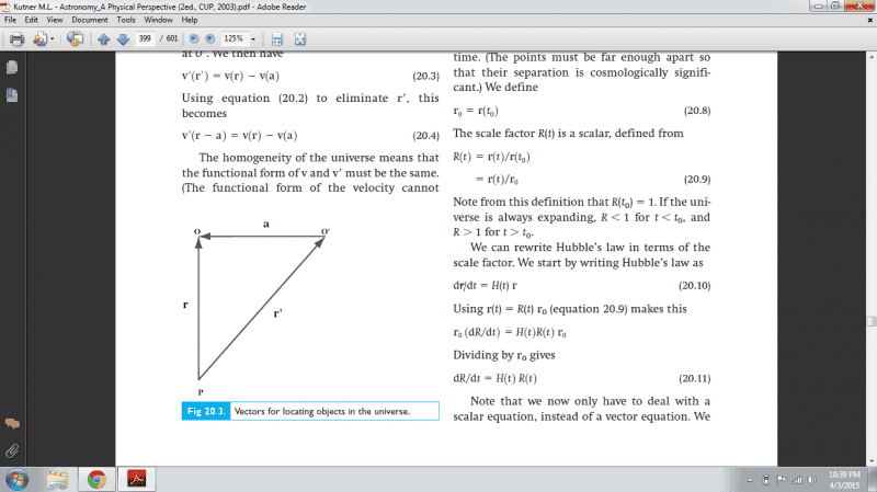

I'm not sure I get it, could you explain it in the sense of the book I am using, on the right side of the page.
Looks like they're using the form usually attributed to ##a(t)##. Notation can be confusing sometimes :P
The basic jist of it is: scale factor doubles, distances between objects doubles. So if two galaxies were a billion light years apart when the scale factor was 0.5, then those two galaxies are currently two billion light years apart (currently the scale factor is defined as 1, using their notation).
Okay, I think I get it. It just gets confusing to me when they throw so many different r(t)s and rs in there. Thanks.
