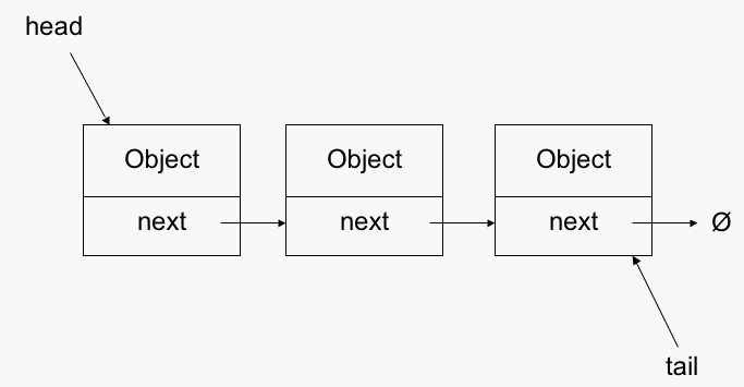

Hello, just having a bit of trouble understanding this bit of code:
typedef int Item;
struct Node {
Item data;
Node* next;
typedef Node* NodePtr
NodePtr hdlist = NULL;
None.
I understand that typedef is used to assign alternative names to existing types. So Item is now (int). Node is the name of the structure and inside the structure we have Item data = int data basically. What I'm not sure about is Node* next.
As far as I am aware, pointers are declared with the int* ptr method. This is a pointer ptr of type int. However does this mean that next is a pointer of type Node? But Node is simply the name of the structure?
Yes, so every Node has a pointer to a(nother) Node. This will be the next item in the list, like this:
What you do is you keep a pointer to the first node in the list, which is called the head. The first item in the list is head->data. From there you can skip to head->next, which is the second node in the list, and the ->next of that is the third node, etc. until you eventually reach the end of the list which has it's next pointer pointing to nothing (null).
There are also variations where every Node has two pointers, one to the next item in the list and one to the previous one, which allows you to go through it in two directions; and computer scientists can probably tell you more complicated ones which have their various advantages (for example for easily searching sorted lists, etc).
To declare a pointer you use syntax that looks like this:
Code:
[[I]type[/I]] * ptr;
In the above, type is some data type, such as int, float, char, or some user-defined type, such as Node in your code.
No it's not. The declaration int * ptr; says that ptr is a variable whose type is "pointer to int." The value that is stored in a pointer is the address of the thing it points to.
No, the type is "pointer to Node."
