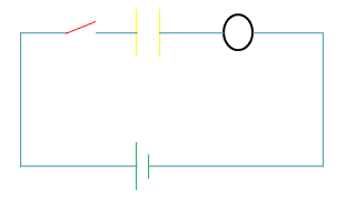

I guess the circuit looks something like this:
Red: switch symbol.
Green: battery symbol.
Yellow: Capacitor symbol.
Black: light bulb.
Likes kuruman

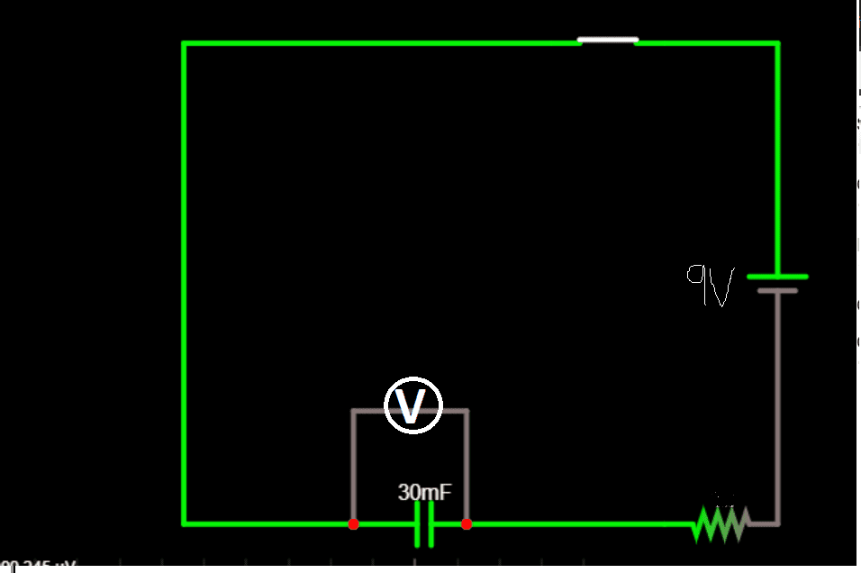

The connection when it was charging was like this: I do not know the rating of the load (light bulb), but the voltmeter measures 0V when it was completely discharges and as we turns on the power supply it climbs up to 12V and it climbs up higher and higher, but slower and slower over time. Does it have something to do with the power supply shoving off more charges? I assume that it would equalize with the supply though. There was also a compass between the light bulb and the capacitor putted above a wiggly wire(not coil).

Help me understand. You have the circuit that you show in post #6 with the switch initially open. Then you close the switch and the voltage across the capacitor starts from zero and reaches a final value of 12 V over some time. Is that correct?
If not a coil, what does this "wiggly wire" represent? Is it part of the circuit?
Does the resistor in the circuit you posted represent the light bulb? Is that what you call the "wiggly wire"?
Can you explain the role of the compass in this?

The wiggly wire was in series the resistor acts as a light bulb. I believe we only used the compass to analyze the magnetic field produced in the circuit.
OK, the wiggly line may be a fuse. You didn't answer my previous question, though,
When you close the switch, does the voltage across the capacitor start from zero and eventually level off to a final value of 12 V, increasing at a decreasing rate over time?

Yes, the voltage across the capacitor starts from zero and starts rising after around 12V it decreases the rate at which it ascends. The wiggly line was just a conductor bent. I do not have a reason why though. My thinking goes that it increases the magnetic field so that the compass needle might be affected stronger for us to see it.
You should get a compass deflection as long as the capacitor is charging which means that there is a current in the connecting wire. Once the capacitor is fully charged, the compass should point in the direction of the Earth's magnetic field. However, I cannot explain how you can get 12 V or more from a 9 V battery on the basis of the circuit you have provided and what you have posted about it. Maybe someone else can figure it out.
What value is the capacitor? 30 microfarads? 30 milifarads? The circuit says mF which is slightly non standard notation.
I ask because of light bulbs are generally low resistance so the time constant should be quite fast? Perhaps too fast to see it charging using a meter?
Are you sure it wasn't a 12 v battery?
OP states power supply of 9v. (?? ac, dc, filtered, ripple, ... )
root2 x 9v = 12.69v peak though.
