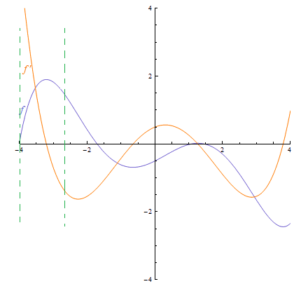

Hello friends,
I'm trying to understand Concavity, But I've some doubts. As we know quadratic polynomial on graphing forms a parabola opening upwards or downwards. While understanding concavity we divide graphs into separate region using inflection points and each separate region is a quadratic polynomial in its own. So, its derivative should be linear. Then why the derivative of function ' f ' in the domain (vertical green line) is not linear.

Hello jfizzix,
Lets just forget about concavity for a while. the graph of a function f under green vertical lines is a quadratic so its derivative must be linear (a straight line). But as we can see from graph f' its not a straight between green vertical lines.

Because the separate pieces of your polynomial function (the blue graph) are not quadratic functions. They only appear to be parabolas, but they aren't.

You have some misconceptions. The function f appears to be a fourth-degree polynomial, so its derivative is a cubic. On intervals where the graph of f is concave up or concave down, the graph has roughly the same shape as a parabola, but that's where the similarity ends.
If the function f under green vertical lines were a quadratic, than its derivative would be linear. Since the derivative is not linear as you see, the function under green vertical lines is not quadratic.
If it were a quadratic, it would also be symmetric about the peak (at least the in between the lines). You can see that on the right of the peak, the function bends up more than it does on the left the same distance form the peak.

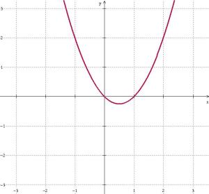

Finally, you seem to define a "parabola" as any function which looks like this:
This is incorrect. A parabola is the same as a quadratic function. So a function ##f## is a parabola if and only if it has the form ##f(x) = ax^2 + bx + c## for any ##x## (and ##a\neq 0##).
So just because it his concave and symmetric and stuff, doesn't mean that it's a parabola.
In particlar, the catenary and the function ##f(x) = x^4## are not parabolas.
