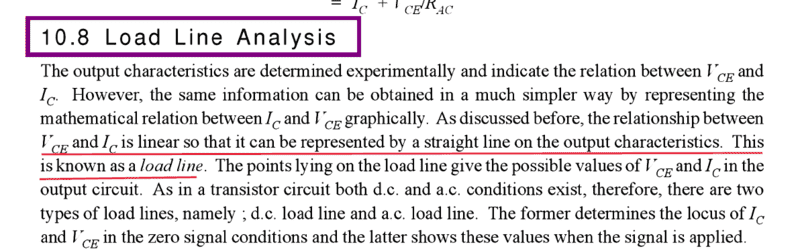

I didn't understand the following:
The relationship between ##V_{CE} ## and ##I_C## is linear.
In active region, even if the ##V_{CE}## increases, ##I_C## remains almost same for a given ##I_B##. So, how can the relation between the two can be linear?
Can anyone tell me the utility of the d.c. load line?
What I lknow is for a faithful amplification, if the Q- point is taken as the midpoint of the d.c.load line, then we will get the desired output.
Is the concept of load line used only for BJT?
Pushoam said:
In active region, even if the VCEVCEV_{CE} increases, ICICI_C remains almost same for a given IB. So, how can the relation between the two can be linear?
This is what the horizontal lines in the graph represent. The slant line describes the relation between IC and VCE as IB is varied (in the active region) and Vcc is kept constant. Hence, for smaller IB, Ic is also small which means VCE is large. As IB goes on increasing, Ic increases as well and VCE decreases.
Load line is used to set the Q point, which is almost the midpoint of the load line. From the above graph, you can see the variation in output voltage w.r.t. variation in base current. This midpoint operation prevents the transistor from going into cutoff or saturation regions and the output waveform is linearly amplified (faithful operation).
This is what I missed. Thank you for helping me.
But even if ##I_B## is varied, ##I_C## is not proportional to ##V_CE##.
Setting Q-point means?
Does it mean that for a desired value of ##I_C## and ##V_CE## such that ##I_C ## is proportional to ##V_{CE}##, the load line helps to determine the input current i.e. the base current?
