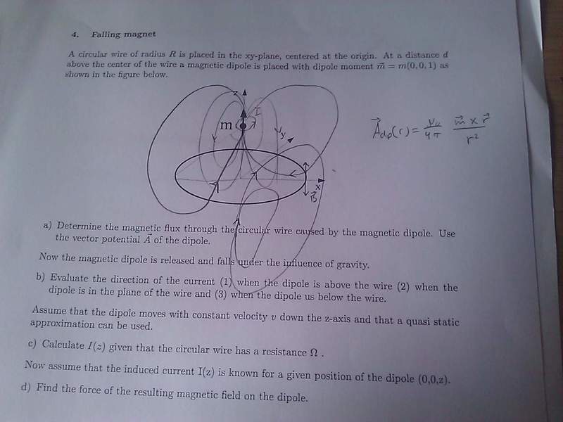

Hi Guys
I have hards time doing a question in electrodynamics, i have uploaded the problem and i can't figure out how to do question a), i have hard time understanding what coordinat system i should use, cartesien og cylendrical. I have tryed to draw the field lines, its a bit messy, but its just a dipole above a loop and i have written down the vector potential equation from Grifiths book intro. to electrodynamics.

We start with a). In the template, you have written down the relevant equation under 2) relevant equations, right ? Small correction to that : ##\vec A_{dp}(r)## should be ##\vec A_{dp}(\vec r)##. Which is the vector potential at a point ##\vec r## due to a dipole at the origin. Right ?
So what is needed to rewrite this in the coordinate system of your exercise (which was already chosen for you, so you don't have to worry about that any more!) ?
Oh, and: welcome to PF. Do use the template. It helps you too (in several ways).

Sort of, yes. Stop worrying about the coordinate system. It is a given. I clearly see an x, a y and a z in the picture.
My "So what is needed ..." tries to point out that this time the dipole is not in the origin, but at (0,0,d)
There is a symmetry around the z axis that allows you to look at (x,0,0) for x from 0 to R and write down ##\vec A(x,0,0)## which I suspect points in the y direction... Your plan of approach seems excellent to me: as you say, take the curl to get B (for which you only need the z component) and integrate.

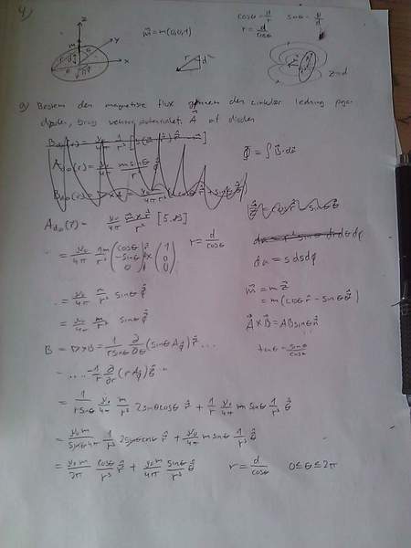

Im pretty weak in vektors for det plan, cylendrical and spherical coordinat systems, but i can see you suggest the plan coordinat system. Well i gave it a try in the sperical coordinate system, i have attached a image of my attempt, but now i don't know what bounderies i should integrate over to get the flux, and don't mind the text, its just the question text in danish language.

Are you familiar with Stokes' theorem?
\int_S (\nabla \times \vec A(\vec r)) \cdot d\vec S = \oint_{\partial S} \vec A(\vec r) \cdot d\vec r
From this you should be able to perform the flux integral without much problem. You should not even need to compute the actual magnetic field.
of coures how could i forget this! great thanks a lot. So i actually just need to integrate phi which goes from 0 to 2pi. but what about my r2 in the vector potiential dipole, i would need to rewrite that one in terms og θ, right?
Yes, you need to express ##r## (and ##\vec r##) in whatever coordinate system you happen to be using. I would use spherical or cylinder coordinates for this.
i have gotten a solution flux = μ_0*m*tanθ/(2*d), can you say anything about this being correct?
