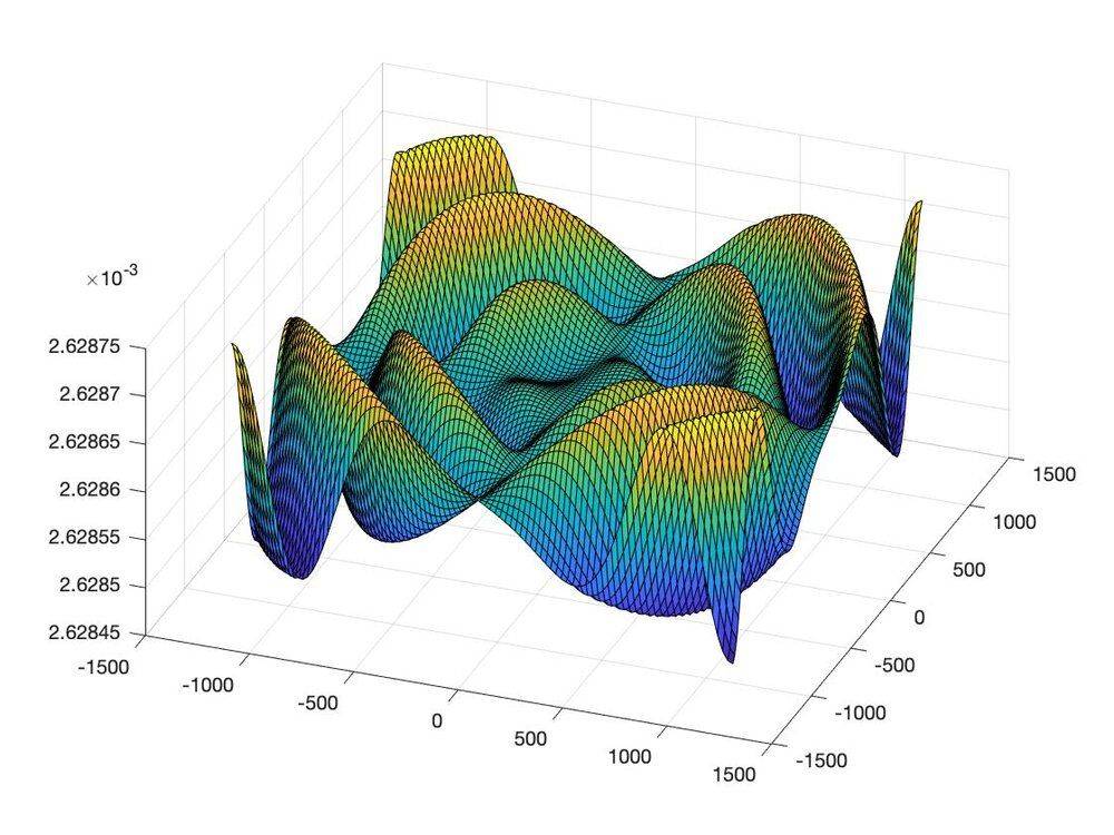

I want to program a diffraction flux pattern from a circular aperture in an infinite plane perfect conductor. I think the result I'm trying to get is a Bessel function type profile with a central maxima. I think this is valid when assuming normal incidence which is what I'll assume from here on out. Maybe I misunderstand Babinet's principle and could use some help/clarification.
See solution below.

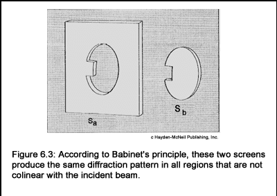

Diagram of Babinet's principle: left, incident plane wave fields E0, B0 and wavevector k0 beside a disk with scattered fields; right, complementary aperture with its fields labeled, with relations E_a^S = -cB_d^S and cB_a^S = E_d^S.
For clarification on "normal incidence" without drawing a picture.
I'm going to assume the incoming wave has the electric field in the z-direction, the magnetic B / Auxillary H-field in the x-direction, and the Poynting Vector in the y-direction (i.e. normal to the plane of the aperture).

When I add back the plane waves per Babinet's principle I get the following
which is nothing like the typical Bessel function like diffraction profile.
Can someone walk me through what I should be doing, and how I should be interpreting it?
It should be worth noting that I found the total fields E and H before finding the total poynting vector so I did not neglect cross terms
  • 3D surface plot in MATLAB with a z-axis scaled by 10^-3 ranging from 2.6284 to 2.62875, showing a rippled, irregular surface over x and y axes spanning -1500 to 1500, coloured by height from blue to yellow.
