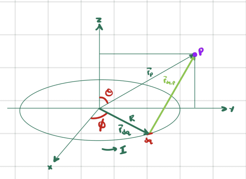

Consider a circular loop of radius ##R## lying in the ##xy##-plane and carrying a steady current ##I##.
Diagram of a circular current loop in the xy-plane with radius R and current I, showing field point P in the yz-plane with position vectors r_P and r_dq,P and a current element dq on the loop at angle phi from the x-axis.

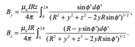

If we compute the magnetic field at a point ##P## off the axis of symmetry in the ##yz##-plane we arrive at integrals that can only be computed numerically
Two equations for the off-axis magnetic field of a current loop: B_y = (mu_0 I R z)/(4 pi) times the integral from 0 to 2 pi of sin(phi') d(phi') over (R^2 + y^2 + z^2 - 2 y R sin(phi'))^(3/2), and B_z = (mu_0 I R)/(4 pi) times the integral from 0 to 2 pi of (R - y sin(phi')) d(phi') over the same denominator.
Note that the ##x##-component of ##\vec{B}## at ##P## is ##0## by symmetry.

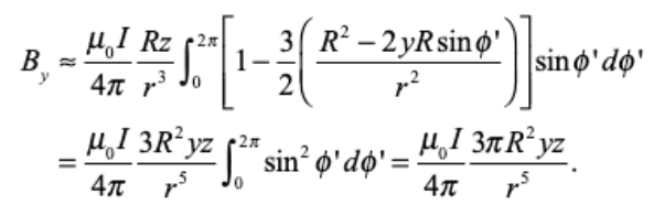

Consider a scenario in which ##R<<(y^2+z^2)^{1/2}=r##. That is, the radius of the ring of current is much smaller than the distance to the field point ##P##.

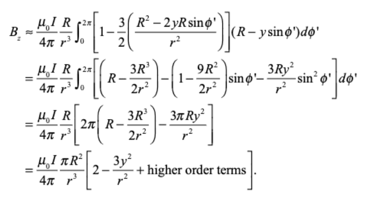

Using linear approximation for the denominator in the expressions for ##B_y## and ##B_z## above, we reach
Two equations for the y-component of the magnetic field B_y of a current loop at a distant point, using a 1 - (3/2)(R^2 - 2yR sin φ')/r^2 expansion, followed by the simplified result (mu0 I / 4pi)(3R^2 yz / r^5) times the integral of sin^2 φ' dφ', giving (mu0 I / 4pi)(3 pi R^2 yz / r^5).
and
Four-line derivation of the approximate axial magnetic field B_z of a current loop, starting from an integral over phi' and ending with B_z approximately mu0 I pi R^2 over 4 pi r^3 times [2 minus 3y^2 over r^2 plus higher order terms].
The notes I am reading say
The quantity ##I(\pi R^2)## may be identified as the magnitude of the magnetic dipole moment ##\mu=IA## where ##A=\pi R^2## is the area of the loop.

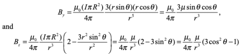

Using spherical coordinates, with ##y=r\sin{\theta}## and ##z=r\cos{\theta}## we can rewrite the expressions above as
Two equations for magnetic field components: B_y = (mu_0 I pi R^2)/(4 pi) times 3(r sin theta)(r cos theta)/r^5 = (mu_0/4 pi) times 3 mu sin theta cos theta / r^3, and B_z = (mu_0/4 pi) times (I pi R^2)/r^3 times (2 - 3r^2 sin^2 theta / r^2) = (mu_0/4 pi)(mu/r^3)(2 - 3 sin^2 theta) = (mu_0/4 pi)(mu/r^3)(3 cos^2 theta - 1).
Finally, the notes say

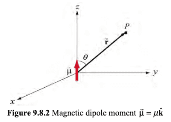

Thus, we see that the magnetic field at a point ##r>>R## due to a current ring of radius ##R## may be approximated by a small magnetic dipole moment placed at the origin
Diagram of a magnetic dipole moment vector mu = mu k-hat, drawn as a red arrow along the positive z-axis from the origin, with point P located at position vector r at angle theta from the z-axis in the yz-plane.

But how do we see this in the equations shown above?
The expressions for ##B_y## and ##B_y## contain a ##\mu## factor in them (but also many other factors). How does this show that we can approximate the ring as a magnetic dipole moment?

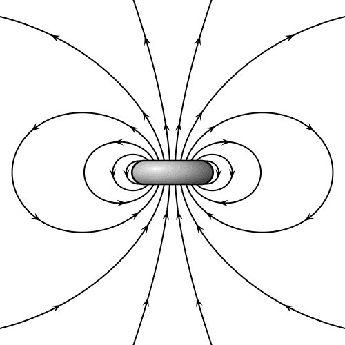

zenterix said:
A magnetic dipole is a current loop.
It is more correct to say that a current loop has a magnetic moment.
Electrons, protons and nuclei also have magnetic moments, yet there are no currents at play.

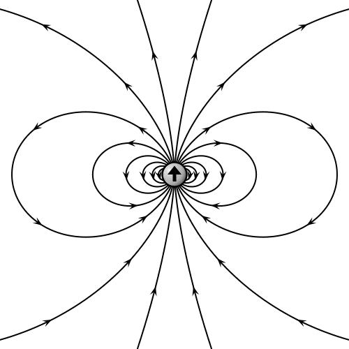

If you are at distances close to a ring of current, the field looks like the figure below left. If you move to distances much larger than the diameter of the ring, you will not be able to see any details and the field would like a point dipole below right. The arrow shows the direction of the magnetic dipole vector.
A square current loop would look different from the circular loop at close distances but the same (point dipole) at large distances.
Magnetic field lines of a dipole: a grey elongated bar magnet in the centre, with closed loops of field lines emerging from one end and curving back into the other, and outer lines sweeping around the sides.
Diagram of a magnetic dipole field: field lines loop out from a central point with an upward arrow, forming symmetric closed loops on both sides and arcing outward to the top and bottom.
I'm not sure I completely understand your question. But, note that the results for ##B_y## and ##B_z## above (far from the current ring) have the same mathematical form as the Electric field of an electric dipole derived in chapter 2 of the MIT notes. See equations (2.7.6) and (2.7.7). The only difference is the electric dipole moment vector is along the y-axis while the magnetic dipole moment vector is along the z-axis. So, this is why we say that far from the current ring, the magnetic field is a dipole field.
@TSny
I think I get it now.
We first define electric dipole. We calculate the field due to this dipole.
Next, we consider a magnetic dipole in the form of a current ring. We calculate the field due to this current ring (at large distances from the magnetic dipole) and notice that the equations are essentially the same as those for an electric dipole at large distances.
Relative to the dipole moment vector, both fields look the same.
The only differences in the equations are that
1) Instead of a magnitude of an electric dipole moment (##|\vec{p}|=2qa##, where ##a## is halfway between the two charges) we have a magnitude of a magnetic dipole moment (##|\vec{\mu}|=IA##, where ##A## is the area of the loop).
2) The dipole moment vector goes from positive charge to negative charge in the electric dipole case, and is perpendicular to the current ring in the magnetic dipole case.

Consider again the sentence
Thus, we see that the magnetic field at a point ##r>>R## due to a current ring of radius ##R## may be approximated by a small magnetic dipole moment placed at the origin.
The current ring has a magnetic dipole moment at the origin (this is just a simple vector defined very specifically). It is not very clear what it means to approximate the magnetic field of the current ring with a magnetic dipole moment at the origin, when this magnetic dipole moment already basically defines the current ring in the first place.
Is the sentence accurate?
Or is "magnetic dipole moment" in that sentence referring to an actual bar magnet?
View attachment 341491View attachment 341492
When you say "would look like a point dipole" do you mean "would look like an electric point dipole"?
In other words, when we refer to dipole, it seems that an electric dipole is the reference against which the magnetic field of a magnetic dipole is compared.
Therefore, we say that the magnetic field of the current ring when we zoom out looks like the field of an electric point dipole (if the electric dipole moment were the same vector as the magnetic dipole vector, or at least had the same direction).

zenterix said:
Now at this point I just want to talk semantics.
Consider again the sentence...
I'm not sure exactly what the author had in mind. But, I believe you can interpret "magnetic dipole moment" in that sentence to refer to a small bar magnet. That is, a system of equal and opposite "magnetic poles" ("north" and "south") separated by a small distance. The dipole moment of this system would be ##md## where ##m## is the magnitude of one of the magnetic poles and ##d## is the distance between the poles.
