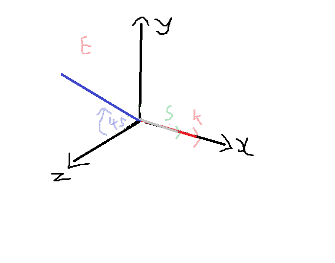

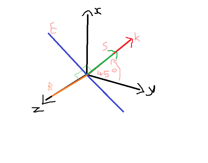

A plane harmonic electromagnetic wave of amplitude Eo and frequency wo is traveling in the positive x direction in a vacuum. It is linearly polarized with its plane of vibration at 45 degrees to the xy plane and the electric field is zero when x=0 and t=0
a) Make a sketch showing the polarization and propagation direction of the wave. Include the directions of E,B and the Poynting vector in the sketch

a)

Have I done this correctly and is my sketch correct ?
3D diagrams are always tricky, but the direction of S looks odd and the direction of k is wrong.
What does "travels in x-direction" tell you about k and possible polarization axes?
Why do E and B depend on y?

I'm not sure where the magnetic field points. Must it always be perpendicular to the E field and direction of propagation ?
Looks better. You could draw the angle between E and y to make the direction of E clearer.
Right.
