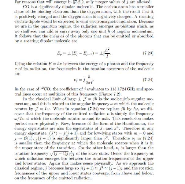

I don't really understand the explanation given in Binney's text about:
Printed page of text from a physics textbook discussing rotational energy eigenstates, angular momentum eigenvalues j(j+1), and how rotation frequencies of upper and lower states converge in the classical limit.

3. Why do low lying states with ##m = 0## and ##j~O(1)## lead to: ## j(j+1) >> j ##? Firstly, doesn't low lying states correspond to a low ##j##? And what does m have to do with anything? ##m## was defined as the eigenvalue of Ji and ##j = m_{max}##
The rest of the argument doesn't make any sense at all..
He didn't say j(j+1) >> j. He said "significantly larger".

It's about the energy levels in rotation spectra of diatomic molecules - specifically CO molecule in this case.
The problem is I'm not sure what he is referring to. This is taken from Binney's book, pg 140:
Printed textbook page of prose and equations on rotational spectra of the CO molecule, showing E_j = ±(E_j − E_{j−1}) = ±j ħ²/I (7.23) and ν_j = j ħ/(2πI) (7.24).

Much more importantly, he said larger than ##j^2##, not j.

Ok besides that, I don't get the rest of the argument about rotation frequencies at all!
Classically, you have two ways to determine the rotation frequency: Either from the energy of the state using: ##\omega=\sqrt(2IE)## or measuring the frequency of the emitted radiation, ##\omega_\mathrm{transition}##. In QM, the energy is quantized, so ω, as determined from E will depend on J. He is saying ##\omega(j-1)<\omega_\mathrm{transition}<\omega(j)##, where the transition is from j to j-1. In the limit of large j, all thre values will converge to the same classical value.
