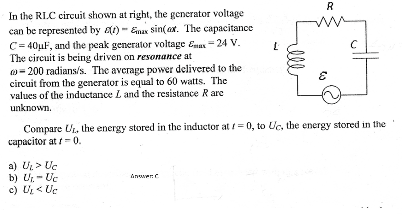

Please check picture
http://i.imgur.com/YMQBR.png
Problem text and circuit diagram of a series RLC circuit with resistor R, inductor L, capacitor C and a sinusoidal generator, with answer choices comparing UL and UC at t = 0 and the answer C given.
Shouldn't all the energy be 0 at beginning?
Thanks!
  • Problem statement and circuit schematic of a series RLC circuit with inductor L, resistor R and capacitor C driven by generator voltage E, with multiple-choice comparison of inductor and capacitor energies at t = 0.
It tells you that this circuit is at resonance. Do you know what this means about the values of Xl, Xc and R.
The question doesn't make much sense!
It is at resonance and that means:
1) Xl = Xc
2) Supply voltage and current are in phase
3) Supply voltage is the voltage across R
4) The power is dissipated in R
This means that you can calculate the value of R. You are given the resonant frequency so you can calculate Xc and therefore Xl.
I don't understand what they are asking !
The problem asks about the energy stored in the inductor and in the capacitor, when the current is zero, so the voltage across the reactive elements is of maximum magnitude. You need the formula for the energy stored in an inductor and in a capacitor.
t=0 does not mean that the source was switched on at that instant. The generator voltage has been the same before we started to measure time.
