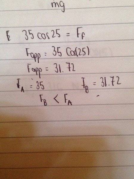

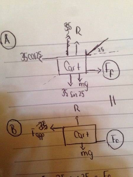

Then the frictional force is equal to his horizontal force true. Please see attachment and tell me if this is correct
Is this where it comes to say that the force is smaller?
Yes.

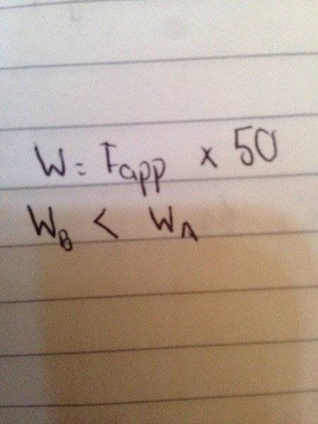

This is not correct the work should be the same whyyyyyy?
omarMihilmy said:
Work = Force x Displacement
But what displacement, exactly? Think about the directions.
It is displaced by 50 meters in the next aisle right?
No, I mean in the statement "work = force x distance", it isn't just any old distance. The distance has a specific relationship to the force. It's to do with the direction of each.
Okay I see that please elaborate more how will it be smaller?
It's the distance in the direction of the force. In vector terms, and allowing for a variable force, it's ∫F.ds, i.e. the integral of the dot product of the force vector with the distance element vector. For a constant force you can simplify that to F.s, again that's the dot product of vectors. If the angle between the force vector and the distance vector is θ then you can write it as |F||s|cos(θ).
So, it doesn't matter whether you consider the distance component in the direction of the force or the force component in the direction of the distance moved - it comes to the same thing.
In the present problem, the movement is horizontal. So you need to compare the horizontal components of the forces for the two cases.
