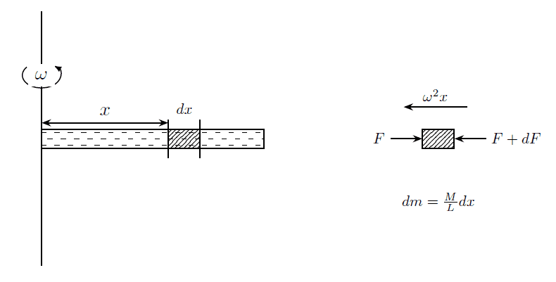

A tube of length '##L##' is filled completely with an incompressible liquid of mass '##M##' and closed at both of the ends. The tube is then rotated in a horizontal plane about one of it's ends with a uniform angular velocity '##\omega##'. Then which of the following statements are true:
  1. The force exerted by liquid at the other end is ##\frac{1}{2}M\omega^2 L##
  2. Ratio of force at middle point and the end point of the tube will be ##4:1##
  3. The force between liquid layers linearly increases with the distance along the length of the tube.
  4. Force is constant.
Note: The question is a multiple correct question
##\vec{F}=m\vec{a}##
Now let's not bother with the options, what I am puzzled about is how to find the force exerted at a linear element at a distance ##x## from the rotation axis. Wouldn't the scenario be just like that of swirling massive rope. In the case of a whirling rope the tension at any point is given by ##\dfrac{M\omega^2}{2L}(L^2-x^2)##, so in this case also wouldn't it be the same. But, wait I also (just like you) doubt that I am entirely correct because in the case of the rope there was no mass or any other body which applied a force (or needed to be rotated at ##x=L##) on the differential element that we were considering at a distance ##L## from the rotational axis, that's why we could find the integral constant by putting ##F=0## as ##c=\dfrac{M\omega^2}{2L}## in the expression ##F=-\dfrac{M\omega^2x}{2}+c##. So, what point do I need to consider for finding out the integral constant in this situation or is it that the situation is not like that of the rope at all.

It's a bit like a rope, but reversed. With the rope, least tension is at the free end, max at the axis end. The water pressure gradient is the othe way around. It is not clear whether you can directly map the rope result across, but you can certainly use an analogous method.
Consider an element dx distance x from the axis. What is its mass? What is its centripetal acceleration? If the pressure on it from the axis side is P(x), what is P(x+dx)?

@decentfellow Have you drawn a free body diagram for the parcel of fluid in the tube between locations x and x + dx, or, do you feel that you have advanced to the point where you no longer need to use free body diagrams? If you have drawn a free body diagram, what are the forces in the x direction acting on the parcel. What is its mass, and what is its acceleration?

No. please just show us your force balance equation for the parcel of fluid between x and x + dx .
@Chestermiller Here I completed it just now.
@Chestermiller Oh I am apologise I saw your post after uploading the pic. From the FBD we can see that
$$dF=(dm)\omega^2x=(\dfrac{M}{L}\omega^2x)dx \implies F=\dfrac{M}{2L}\omega^2x^2+c$$
Now after such a long thread I have totally understood what I have to do here, which is to consider the force acting at ##x=0## is ##F=0##.
So we get ##c=0##, hence ##F=\dfrac{M\omega^2x^2}{2L}##

Excellent. Now, the only other thing to add is P(x) = F(x)/A.
