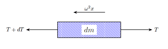

A uniform rope of mass ##M## and length ##L## is pivoted at one end and whirls with uniform angular velocity ##\omega##. What is the tension in the rope at distance ##r## from the pivot? Neglect gravity.
$$\vec{F}=m\vec{a}$$
Consider the differential element as shown in the figure.
I considered the setup of the tension acting on the differential element as such because I thought that net force that should be acting on the differential element should be in the direction of the centripetal acceleration. So, we get
$$T+dT-T=(dm)\omega^2x\implies dT=\left(\dfrac{M}{L}\omega^2x\right)dx$$
On, integrating the expression with proper limits we get
$$\int^{T}_{T_0}{dT}=\int^{r}_{0}\left({\dfrac{M}{L}\omega^2x}\right)dx \implies T-T_0=\dfrac{M}{2L}\omega^2r^2$$
Now, to find ##T_0##, we put the value of that ##T## which acts at the end of the rope. The value of ##T##, i.e. the value of the tension acting in the direction opposite to the direction of the acceleration of the element we see that the value of ##T## is ##0## as there is no tension acting in the outward direction of the rope.
So, we get $$-T_0=\dfrac{M}{2L}\omega^2L^2\implies T_0=-\dfrac{M}{2L}\omega^2L^2$$
$$\therefore T=T_0+\dfrac{M}{2L}\omega^2r^2=\dfrac{M}{2L}\omega^2\left(r^2-L^2\right)$$
The answer that I get has an opposite sign than that of the book's, which is ##\dfrac{M}{2L}\omega^2(L^2-r^2)##. Is it because the direction in which I considered ##T## to act is opposite to what I had assumed. If that is so, then doesn't that mean that ##T+dT(\gt T)## is in the direction opposite to that of the centripetal acceleration, so how would the centripetal acceleration be supplied to the differential element if the net force is in the direction opposite to that of the centripetal acceleration.
You have defined the change in the x coordinate as the right minus left value of x while defining the change in the tension as the left value minus the right. This gives you a sign error.
But shouldn't the gravity increase as we go towards the center of the circle in which the circle whirls. Does, it just mean that the expression ##dT=\left(\dfrac{M}{L}\omega^2x\right)dx## should be ##dT=-\left(\dfrac{M}{L}\omega^2x\right)dx##.
Also, I had not read the "neglect gravity" part of the question so I was thinking that what should be the minimum velocity for which the whole of the rope rotates , i.e. the rope doesn't slacken anywhere while rotating. And I was not able to think of a way to approach this problem, if you can suggest how to attempt it would be very helpful.
"Gravity" does not. The tension does. You must define dT and dx in compatible ways. You cannot take the difference for the x coordinate one way and the difference in the tension another and then expect to get the correct result.
decentfellow said:
Does, it just mean that the expression dT=(MLω2x)dxdT=(MLω2x)dxdT=\left(\dfrac{M}{L}\omega^2x\right)dx should be dT=−(MLω2x)dxdT=−(MLω2x)dxdT=-\left(\dfrac{M}{L}\omega^2x\right)dx.
Yes.

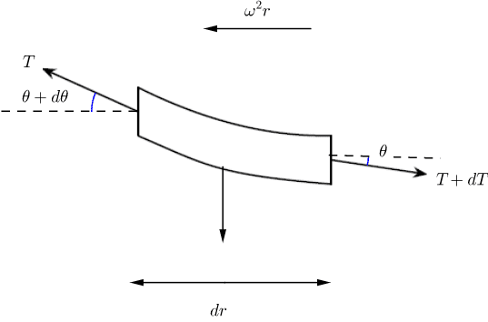

For the gravitational case, consider an element of horizontal length dx at horizontal distance x from the tether.
Suppose the element makes angle θ to the horizontal at one end and θ+dθ at the other.
Similarly, let the tension be T at one end and T+dT at the other.
If it has linear density ρ and the rotation rate is ω, what is the mass of the element and what are the forces on it?

Hmm...I was thinking of doing it by considering ##dx## and ##dy## as the differentials for the horizontal and the vertical heights respectively, but the ##d\theta## differential is always handy, don't know why I didn't think of it. Now then ,what I did is as shown as follows:-
The horizontal length of the differential element as given in the figure is taken as ##dr##, so the length of the differential comes out to be ##dx\sec\theta##.
So, we get the mass of the differential as ##dm=\dfrac{M}{L}\sec\theta dr##
Now, dealing with the horizontal force equation of the differential we get
$$T\cos{(\theta+d\theta)}-(T+dT)\cos\theta=dm(\omega^2r) \\
\implies T\cos\theta-T\sin\theta d\theta-T\cos\theta-\cos\theta dT=\dfrac{M\sec\theta}{L}\omega^2rdr$$
$$\implies T\sin\theta d\theta+\cos\theta dT=-\dfrac{M\sec\theta}{L}\omega^2rdr \tag{1}$$
And doing the same for the vertical force equation we get
$$T\sin{(\theta+d\theta)}=(T+dT)\sin{\theta}+dmg$$
$$\implies T\cos\theta d\theta-dT\sin\theta=\dfrac{Mg\sec\theta}{L}dr\tag{2}$$
$$(1) + (2) \implies T(\sin\theta+\cos\theta)d\theta +(\cos\theta-\sin\theta)dT=\dfrac{M\sec\theta}{L}(g-\omega^2r)dr$$
Now only if there was no ##\sec\theta## in RHS it would have been a lot easier, but am I going the right track.
Yes, that's a good start. I would have put θ on the left and θ+dθ on the right to be consistent. As you have it you will have to be careful with signs.
For ease of writing, I would write ρ for a linear density to replace M/L.
There's not much point in adding the two equations together like that at the end. It loses information without eliminating a variable.
Manipulate the equations to get an equation without T' (by which I mean dT/dr) into the form T=... Differentiate that to get an equation for T'. You can then use those equations to eliminate T and T' from one of your two equations.
Note that you will then have a second order differential equation. That's the price for eliminating a variable.

Yes. As you have it, dθ/dr>0 would correspond to the slope decreasing as r increases.

I did as what you instructed to and what I got was ##\sin\theta=c_1(r-\dfrac{L}{2})##, but on putting ##\dfrac{d\theta}{dr}=\dfrac{c_1}{\cos\theta}## in the expression
$$\dfrac{dT}{dr}=\dfrac{\rho\sec\theta\omega^2r+T\sin\theta\dfrac{d\theta}{dr}}{\cos\theta} \\
=\dfrac{\rho\omega^2r+Tc_1\sin\theta}{\cos^2\theta} \\
\implies \dfrac{dT}{dr}+Tc_1\tan\theta\sec\theta=-\rho\omega^2r\sec\theta$$
On solving the above linear differential equation some ridiculous relation between the variables ##T, \theta \text{and} r##
$$T=\dfrac{\rho\omega^2}{2\sin^2\theta c_1^2}(1+\cos{2\theta})+k_1e^{-\frac{2c_1r\sin\theta}{\cos{2\theta}+1}}-\dfrac{\rho r \omega^2}{c_1\sin\theta}$$

I do not understand how you avoided getting a second order DE. You should have got ##T=\rho(g-\omega^2r\tan(\theta))/\theta'##. Differentiating that will give ##\theta''## terms.
I did get a 2nd order differential equation b/w ##\theta \text{ and } r##, which was ##\dfrac{d^2\theta}{dr^2}=\tan\theta\left(\dfrac{d\theta}{dr}\right)^2##, which gives ##\sin\theta=c_1r+c_2##
I thought that I should also show my work, so here goes:-
$$T\cos(\theta+d\theta)-(T+dT)\cos{\theta}=(dm)\omega^2r \\
\implies T\sin\theta\dfrac{d\theta}{dr}+\cos\theta dT= -\rho\sec\theta\omega^2rdr \qquad\qquad\qquad\qquad...(1)$$
From ##(1)##, we get $$\dfrac{dT}{dr}=-\dfrac{\rho\sec\theta\omega^2r+T\sin\theta\frac{d\theta}{dr}}{\cos\theta}$$
From the vertical force equation we see from post #13, that
$$T\cos\theta \dfrac{d\theta}{dr}-\sin\theta dT=\rho g\sec\theta dr \\
\implies T\cos\theta + \tan\theta \left(\rho\sec\theta\omega^2r+T\sin\theta\dfrac{d\theta}{dr}\right)=\rho g\sec\theta \\
\implies T\sec\theta\dfrac{d\theta}{dr}=\rho\sec\theta(g-\omega^2r\tan\theta) \\
\implies T\dfrac{d\theta}{dr}=\rho(g-\omega^2r\tan\theta)$$
Now differentiating the above expression throughout w.r.t ##r##, we get
$$\dfrac{dT}{dr} \dfrac{d\theta}{dr}+T\dfrac{d^2\theta}{dr^2}=\rho(-\omega^2r\sec^2\theta)\dfrac{d\theta}{dr} \\
\implies T\dfrac{d^2\theta}{dr^2}=T\tan\theta\left(\dfrac{d\theta}{dr}\right)^2$$
On solving the differential equation, we get
$$\sin\theta=c_1r+c_2$$

You omitted to differentiate the r factor on the right.
Oh no...that was a blunder on my part :headbang:. Although it seems that adding the r factor results in a second order nonlinear differential equation, which I am not able to solve with the level of skills that I have in maths. Moreover, it seems that if I eliminate ##\dfrac{dT}{dr}## from the expression even then I won't be able to eliminate ##T## form the expression. And if I try to eliminate ##\dfrac{d\theta}{dr}##, then its even harder to eliminate the trigonometrical terms from the expression, I won't even bother going that direction. Can you suggest some other way, or is it better to drop it here.
P.S.:- Forgot to write the expression that I got as the second order non-linear differential equation, so here it is.
$$T\cot\theta\dfrac{d^2\theta}{dr^2}-T\left(\dfrac{d\theta}{dr}\right)^2=-\rho\omega^2$$

In your post #20, in the line preceding
decentfellow said:
Now differentiating the above expression throughout w.r.t r, we get
you have an expression for T in terms of r and theta. Just substitute from that in the equation above. (I have not yet checked whether I get the same.)
