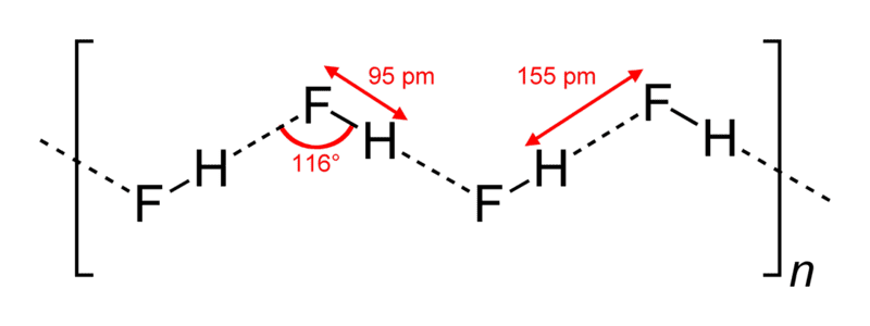

My textbook compares this with Fluorine, which it says can only form two bonds because it has 3 lone pairs on the F atom but only one H atom...
H-F...H-F...H-F
This makes no sense to me. Why would Fluorine, which has 3 lone pairs as opposed to water's 2 lone pairs, not form just as many bonds than water?
Can't each lone pair attract it's own hydrogen just like each lone pair of water attract's each own hydrogen?

Your description is qualitatively reasonable, and I think the end result is the correct one. However, the physical basis of your reasoning can't be the whole story, since H-bonding interactions are not purely electrostatic in nature, but have partial covalent character as well, and thus are directional.
Having said that, your explanation does capture the essence of the answer, which is that while an HF molecule can in principle *accept* 3 H-bonds, it can only donate one. Thus in pure HF, each molecule is (on average) donating one H-bond and accepting one H-bond. At any given time, a particular HF molecule might be accepting more than one H-bond, but over time, the average value of accepted H-bonds must be no larger than one.
On the other hand, water can donate two, and accept two ... so it is natural to find it with a tetrahedral arrangement of H-bonds around it (two donated and two accepted).

Yes I think spatial is part of the key, but hydrogen bonding does occur in HF.
The two lone pairs in water are on the opposite side to the two bonded hydrogens.
This cannot happen if there are three lone pairs.
Further the ratio of hydrogen to oxygen is 2:1 whereas the ratio of hydrogen to flourine is 1:1
2:1 allows cross linking - 1:1 limits the linking to chains
See this extract from WP
Near or above room temperature, HF is a colorless gas. Below −83.6 °C (−118.5 °F), HF forms orthorhombic crystals, consisting of zig-zag chains of HF molecules. The HF molecules, with a short H–F bond of 95 pm, are linked to neighboring molecules by intermolecular H–F distances of 155 pm.[1]
Liquid HF also consists of chains of HF molecules, but the chains are shorter, consisting on average of only five or six molecules.[2] The higher boiling point of HF relative to analogous species, such as HCl, is attributed to hydrogen bonding between HF molecules, as indicated by the existence of chains even in the liquid state.
(I learned chemical bonding recently, I don't know whether my diagram is correct)
