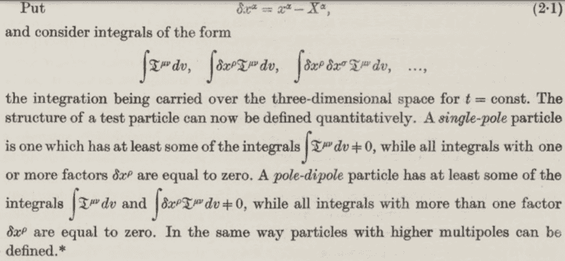

I'd appreciate some clarification of this passage in the paper Spinning test particles in general relativity by Papapetrou,
The definition is easy enough to understand, but what's the motivation? ##X^{\alpha}## are the coordinates of points on the worldline whilst ##x^{\alpha}## are presumably arbitrary spacetime coordinates (of points near the worldline).
n.b. ##\mathfrak{T}^{\mu \nu} = \sqrt{-g} T^{\mu \nu}## and\begin{align*}

It looks like a Cartesian multipole expansion similar as in electrodynamics, where you have the electric current density ##J^{\mu}## as a source, while here it's of course the energy-momentum tensor as a source of the gravitational field.
If beside [itex]\int d^3x \sqrt{-g} T^{\mu\nu} \neq 0[/itex], you have a vanishing higher moments, [itex]\int d^3x \sqrt{-g} \delta x^{\rho}T^{\mu\nu} = 0[/itex] for all [itex]\rho, \mu, \nu[/itex], then the object has no structure, i.e., a single-pole particle. And if the first moment does not vanish, i.e. for some values of the indices, [itex]\int d^3x \sqrt{-g} \delta x^{\rho}T^{\mu\nu} \neq 0[/itex], the object has a structure, i.e., pole-dipole particle. See equations 6,7 and 8 in
