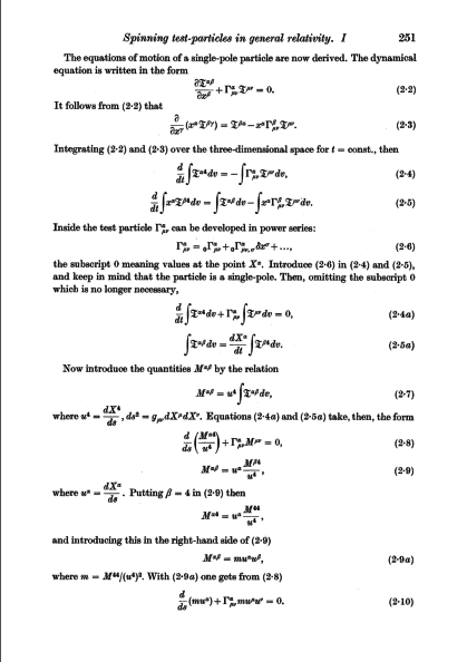

However I wanted to see the original derivation by Papapetrou, as it would be more suited to my needs. There are however a few steps in the paper that I cannot follow. The paper is here: http://rspa.royalsocietypublishing.org/content/209/1097/248 but I don't know how many of you will be able to access it so let me just attach an image of the single page relevant to my preliminary questions.
Equation (2.2) is itself perplexing to me. I've stared at it for hours and I can't see how he gets it so I must be missing something very simple. When he refers to the "dynamical equation" he is talking about ##\nabla_{\beta}T^{\alpha\beta} = 0## (he uses ##\mathfrak{T}^{\alpha\beta}## for ##T^{\alpha\beta}## and note the time-like component is the 4th as opposed to zeroth component in his calculations). But this is equal to ##\partial_{\beta}T^{\alpha\beta} + \Gamma^{\alpha}_{\mu\nu}T^{\mu\nu} + \Gamma^{\beta}_{\beta \gamma}T^{\alpha\gamma} = 0##. He doesn't have the ##\Gamma^{\beta}_{\beta \gamma}T^{\alpha\gamma}## term and certainly it doesn't vanish in general so why does it vanish for the derivation of the single-pole and pole-dipole equations of motion?
My next concern is regarding the power series (2.6) for the connection coefficients inside the particle worldtube. The integrals (2.4) and (2.5) that (2.6) is inserted into is, according to Papapetrou, over "the three dimensional space ##t = \text{const.}##". Does this refer to an entire space-like hypersurface of space-time or just the intersection of the space-like hypersurface with the worldtube of the particle? If it is the former then I don't see how it is valid to insert (2.6) into the integrals given that the power series is only valid inside the worldtube whereas the integrals extend outside of it. If it is the latter then inserting (2.6) into the integrals would be valid but the equalities (2.4) and (2.5) themselves would not be valid for, considering for example (2.4), the equality only holds through the divergence theorem if ##T^{\alpha\beta}## has compact support on the integration domain which won't be true if the domain is the intersection of the space-like hypersurface with the particle worldtube: [tex]\frac{d}{dt}\int_{\Sigma} T^{\alpha 0}d^3 x = \int_{\Sigma} \partial_0 T^{\alpha 0}d^3 x = -\int \partial_i T^{\alpha i}d^3 x - \int_{\Sigma} \Gamma^{\alpha}_{\mu\nu}T^{\mu\nu}d^3 x = -\int_{\partial \Sigma} T^{\alpha i}n_i d^2 x - \int_{\Sigma} \Gamma^{\alpha}_{\mu\nu}T^{\mu\nu}d^3 x[/tex] and ##\int_{\Sigma} T^{\alpha i}n_i d^2 x = 0## only if ##T^{\alpha\beta}## has compact support on ##\Sigma##.
