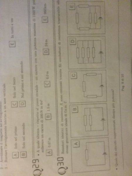

Why in a circuit in parallel I can't use P= i^2 R where R is the equivalent resistance? Why do I have to use P= V^2/R ?
P= Vi , P= V^2/R , P= i^2R[/B]

Q30, it asks to find the circuit which dissipate more power, all the resistance are R and the difference of potential is ε, why can't I find in each circuit the total resistance and say that the power is P= i^2 R and say that i is the same in each circuit? (So I can find out which dissipate more power by looking at the total resistance)
Isn't the current i the same in each case?
Why do I have to use P= ε^2 /R ? Isn't the same thing as using P= i^2 R ?

I'm not able to see your very dim attachment.
Are you familiar with how current divides into parallel circuits? Maybe that's the disconnect here. For parallel circuits, the voltage is the same but the current flows through both parallel branches...

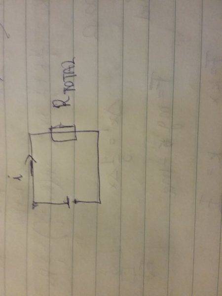

Yes I knew that, but I thought that calculating the total resistance is was able to "transform" each circuit into one with one resistance with a current i like that: (photo)
Then other approach that I had thinking at the problem was thinking that maybe i would have been different in each circuit
(Sorry for bad english )
Just thought that the current was the same in each case

Quite so. Reducing the parallel resistors to an equivalent single resistance allows you to work out the total current, but it does not tell you how much of that flows in each. The two individual currents will be in inverse proportion to the resistances.

yes, you can do it that way, but it is simpler just to apply V2/R to each in the first place.

V2/R? You can derive it from V=IR and P=IV.

P=I2R. Put I=V/R. Voltage is same across parallel resistors. So, power will be inversely proportional to the resistance value.
