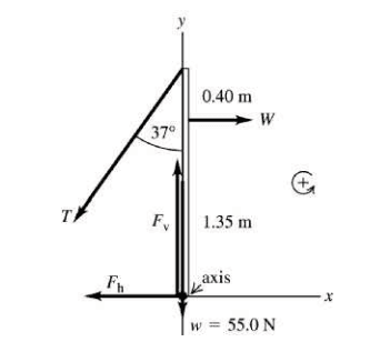

I don't understand the forces ## F_h## and ##F_v##
##\sum F_x=0##
##\sum F_y=0##
##\sum \tau =0##

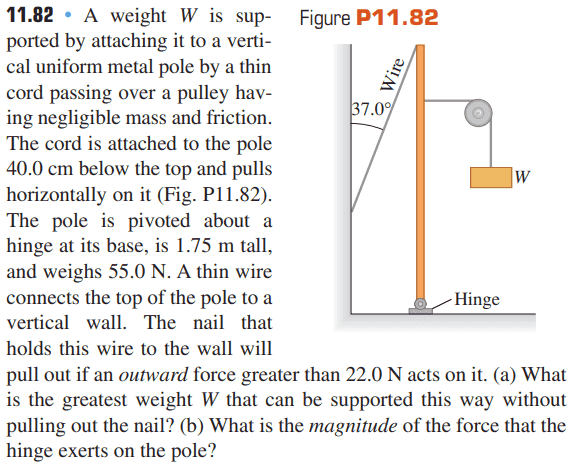

So I have this problem
Free-body diagram of a uniform pole pivoted at a hinge at its base, held by a wire at 37.0 degrees to the vertical wall, with a cord over a pulley supporting weight W.
The soultion to the problem gives me this drawing
Free-body diagram of a vertical rod hinged at its base on an axis, held by a cable T at 37 degrees from the vertical, with horizontal force W at 0.40 m, vertical force Fv, horizontal force Fh at the axis, and weight w = 55.0 N at the bottom; lengths 1.35 m marked.
But I don't understand what ##F_h## and ##F_v## is
Those are the vertical and horizontal components of the reaction force that the pivot exerts over the the metal pole.

This can be solved without trigonometry.
... except to find the height of the nail?
Btw, @Kolika28 , problem setters often choose 37 degrees because it is a close approximation to an angle in a 3,4,5 triangle. Knowing that will make the trig trivial.
They don't ask for the height of the nail, and don't give enough information to compute it if they did ask, but I still stand corrected.
Part (a) does not require trig but computing fV, part of the (b) answer requires a bit of trig, which as you point out, can be done in your head due to the choice of angle.
You’re right, there's not enough information for that, which means I misinterpreted "outward" force. I would have banged the nail in pointing up into the wall, but then the question would would make no sense, so I took it to be horizontal. Outward from the wall is then also horizontal, but then you would need to be able to find the height of the nail.
This leaves only that the nail was inserted in the same straight line as the cable. Not only is that an incompetent installation, but the question could simply have specified a maximum tension in the cable and avoided the ambiguity.
Kolika28 said:
Ohh, that makes sense! Thank you so much!
You are welcome :smile:
