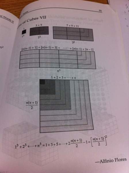

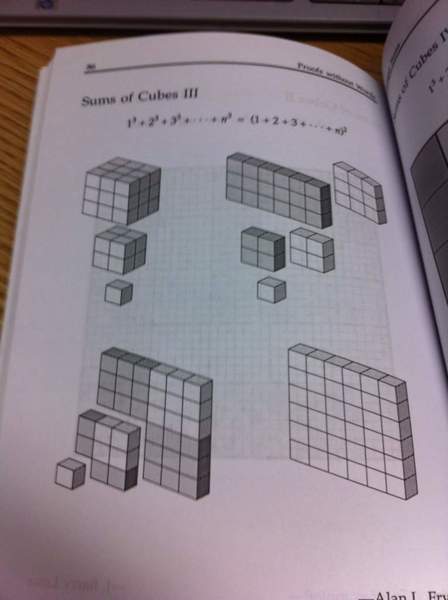

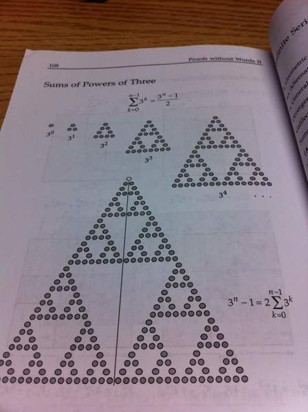

There are these series of books out there labeled Proof Without Words by Roger B. Nelsen which are FILLED with similar examples to this type of problem. They don't provide the proof, that's left up to you, but all of the content is viewed geometrically.
I've attached three "proofs"from the book that I thought were interesting.
Those proofs are amazing! Thanks, scurty! I'll check out that book.
The third one reminded me of the Sierpinski fractal. :D
