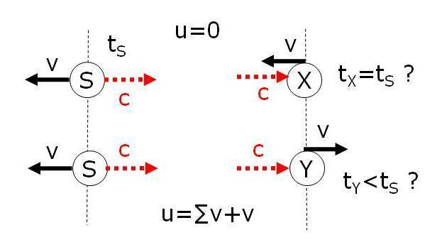

By virtue of its name, the idea of relativistic Doppler initially seems to be an extension of the basic http://en.wikipedia.org/wiki/Doppler_effect" . However, in terms of the physical mechanism at work, this seems to be somewhat misleading; for the basic Doppler effect only seems applicable to a continuous wave propagating though some physical medium. The outline of gravitational redshift cited above also seems a bit vague on the actual cause of the redshift, i.e. exactly when and where it occurs. Equally, the explanation of cosmological redshift appears to default to a description in terms of an expanding universe and the ‘stretching’ of the wavelength of light in transit. How these explanations are actually applied to a photon is unclear, although this is possibly understandable given the general vagueness surrounding the structure of a photon in transit. This said it would seem that the basic physics of both relativistic and gravitational redshift might both be explained in terms of time dilation.
In the diagram attached to this 1st post, a source (S) can either be thought of as a very small mass (m) with a relativistic velocity (v) or a very large stationary mass (M) that is emitting photons into the vacuum at a fixed frequency [f] with an energy [E=hf]. How any subsequent measure of frequency and energy of the photons is determined would seem to depend on the description of the destination in terms of its relative mass and/or its velocity. Therefore, the 1st diagram shows 2 permutations, where (X) and (Y) either represent another equal mass (M) or another small mass (m) traveling with a corresponding velocity (+/-v). For the purposes of this description individual photons are emitted from the same source (S) and arrive at (X) and (Y) at the same point in space after the same relative time with respect to (S).
So what redshift is measure and why?
Speculating on the ‘why’ first. If the redshift is explained in terms of either velocity or gravitational time dilation, the measure of redshift would depend of the relative tick of the clock in the source and destination.
In the case of (X), if its velocity (v) is in the same direction as (S), it would seem to have no relative velocity with respect to (S).
If so, would the tick of the clock in (S) and (X) be the same, such that there would be no redshift?
In the case of (Y), its velocity is in the opposite direction as (S), therefore the issue of time dilation needs to be resolved. While, at face value, (S) and (Y) are both inertial constant velocity systems with a relative velocity based on the relativistic sum of [u=v+v], either might declare the other to be the frame in motion. Therefore, (Y) declares the clock in (S) must be ticking slower and the frequency [f] should be redshifted. However, let (S) and (Y) be occupied by twins and note that it was actually (Y) that earlier accelerated away from (S), plus we now understand (S) to be stationary with respect the CMB frame.
If so, might it be argued that time in (Y) is ticking slower, so would the frequency (f) be blueshifted at (Y)?
At this point, we might switch the description of the relative perspective of (S), (X) and (Y) in terms of 3 large stationary masses with no relative velocity. This set of permutations would seem to suggest that all 3 sit in an identical gravitational field and therefore are all subject to the same time dilation.
If so, would there be no redshift in these cases?

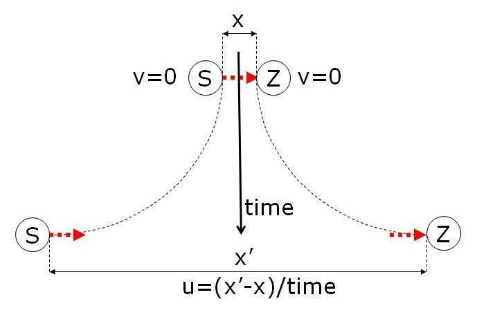

As an extension of post #1, in the diagram attached to this post, the source (S) and destination (Z) might be described as having no effective mass or apparent velocity, as both (S) and (Z) are both stationary with respect to the CMB frame and initially separated by some relatively small distance (x).
As such, might we assume that the tick of the clock is the same in (S) and (Z) and therefore no redshift would be observed associated with photons emitted from (S) and arriving at (Z)?
However, over a huge time scale, the distance (x) is subject to ‘space expansion’ such that (S) and (Z) might be said to end up receding away from each other with a perceived and relative velocity , even though they remain stationary with respect to the CMB frame.
So does the description of cosmological redshift require photons arriving at (Z) from (S), at some later time, to always be redshifted?
Post #1 outlined a number of permutations regarding time dilation caused by relativistic velocity and gravity, but it is not clear what actually causes this redshift in this case.
Space stretches and in so doing it stretched the wavelength of the photon?
It seems very difficult to align this description to any known physics. First, the structure of a photon in transit appears to be unknown; plus most descriptions of the expansion of space seem to then suggest that this will still leave most structures unaffected, e.g. atoms, solar systems and even galaxies. Therefore, the only advantage of the ‘stretching’ idea seems to be that you don’t have to address the issues thrown up by time dilation.
So if we abandon the idea of stretched space, what about time dilation?
Well, initially, it was suggested that the tick of the clock in (S) and (Z) was the same, as no gravity or relative velocity appeared to be involved. However, after many billions of years, (S) and (Z) now appear to be receding with an effective velocity (u) due to what is described as the ‘expansion of space’. This velocity can exceed the speed of light [c], but is said not to violate special relativity because this velocity cannot be measured in any local frame.
So, is this relative velocity ‘real’ in the sense that it causes time dilation?
However, in order to determine the nature of red/blue shift, we would need to resolve the level of time dilation in each frame of reference. Unlike the resolution of the twin paradox, it seems difficult to attach any acceleration force to either of these frames in order to resolve the relative tick of time. However, the stretched space analogy seems to suggest that redshift would be observed in all frames in an expanding universe.
So what description of cosmological redshift is generally accepted and what physics is used to explain it?
Would really appreciate any informative insights on the issues raised. Thanks
