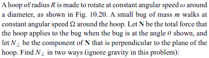

Find the perpendicular component of N in an inertial frame and in a non-inertial frame
newton equation for non inertial frames
I know that the perpendicular force is the Coriolis force, but I don't know how to get it
Do you know what causes the Coriolis effect ? Why it exists. What is the other force ?
