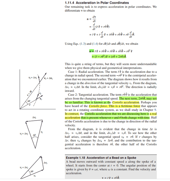

In Kleppner and Kolenkow's book: An Introduction to Mechanics, on page 34 (pasted below) on the topic titled "Acceleration in Polar coordinates", it has been mentioned that: "when ##r## and ##\theta## both change, then Coriolis acceleration acts which is ##real## and is "##In## ## contrast ##" to the Coriolis force which acts in a rotating frame of reference. "
What I'm trying to understand is that:
(1) If we are analyzing the situation using polar coordinate system, then if ##r## and ##\theta## both are changing, then Coriolis acceleration that acts (which by the way is real according to Kleppner and Kolenkow), is this Coriolis acceleration different from the Coriolis acceleration that would come into play due to Coriolis force, if we analyse the same situation from a rotating frame of reference ?
(2) Can Coriolis acceleration (real one) and Coriolis acceleration (due to Coriolis force when seen from rotating frame of reference) act simultaneously at a moving body(whose ##r## and ##\theta## both are changing with time), if we observe from a rotating frame of reference using polar coordinate system ?
$$\overrightarrow{a} = (\ddot{r}-\dot{\theta}^{2}r)\hat{r}+(\ddot{\theta}r+2\dot{r}\dot{\theta})\hat{\theta}$$
I'm not sure your textbook's use of the term Coriolis acceleration is standard. As far as I can find online, it means the apparent acceleration resulting from the Coriolis force. The term referred to in the expression for acceleration in polar coordinates I would have called the Coriolis term.

I found the answer on wikipedia for my original question that makes atleast some sense (https://en.wikipedia.org/wiki/Mechanics_of_planar_particle_motion). I'm posting this with the thought that if someone in future comes with the same doubt as in the original question that i have posted, then their time and effort is not wasted by useless discussion about the definition of what the terms real and pseudo even mean.
Here are some scribblings. I considered a mass moving at constant velocity ##\mathbf{v}##, parallel to the y-axis at constant distance ##x## from it. In Cartesian coordinates the position vector is $$\mathbf{r}=x~\mathbf{\hat x}+vt~\mathbf{\hat y}.$$We have polar unit vectors $$\mathbf{\hat r}=\frac{\mathbf{r}}{\|r\|}=\frac{x~\mathbf{\hat x}+vt~\mathbf{\hat y}}{\left[x^2+v^2t^2\right]^{1/2}}~;~~\mathbf{\hat \theta}=\frac{-vt~\mathbf{\hat x}+x~\mathbf{\hat y}}{\left[x^2+v^2t^2\right]^{1/2}}.$$ For the radial derivatives $$\dot r=\frac{v^2t}{\left[x^2+v^2t^2\right]^{1/2}}~;~~\ddot r=\frac{v^2 x^2}{\left[x^2+v^2t^2\right]^{3/2}}$$For the angular derivatives with ##\tan\theta = vt/x##,$$\begin{align} & \frac{v}{x}=\frac{d}{dt}(\tan\theta)=(1+\tan^2\theta)\dot\theta\implies \dot\theta=\frac{vx}{x^2+v^2t^2} \nonumber \\
& \ddot\theta=-\frac{2tv^3x}{\left[x^2+v^2t^2\right]^2}=-2\dot r\frac{vx}{\left[x^2+v^2t^2\right]^{3/2}} \nonumber \end{align}$$ We can now assemble the acceleration terms a la Kleppner & Koleshnikow.
Radial
##a_r=\ddot r=\dfrac{v^2x^2}{\left[x^2+v^2t^2\right]^{3/2}}.##
Centripetal
##a_c=-r\dot {\theta}^2=-\left[x^2+v^2t^2\right]^{1/2}\left(\dfrac{vx}{x^2+v^2t^2}\right)^2=-\dfrac{v^2x^2}{\left[x^2+v^2t^2\right]^{3/2}}.##
Tangential
##a_t=r\ddot\theta = \left[x^2+v^2t^2\right]^{1/2}\left(-2\dot r\dfrac{vx}{\left[x^2+v^2t^2\right]^{3/2}}\right)=-\dfrac{2\dot r v x}{x^2+v^2t^2}.##
Coriolis
##a_{cor}=2\dot r \dot \theta=2\dot r \left(\dfrac{vx}{x^2+v^2t^2}\right )=\dfrac{2\dot r v x}{x^2+v^2t^2}.##
We see that no term is zero but the sums of the terms in the radial and tangential directions are zero. Given non-zero numerical values for ##v## and ##x##, one can calculate each of the four terms as a function of time. It is comforting that the sum of the radial parts and the sum of the tangential parts are both zero at all times.
Also note that if one sets ##x=0##, all four terms vanish identically as does the particle's angular momentum about the origin. It seems to me that we need to treat the four acceleration components the same way we treat angular momentum and torque. We cannot talk them without specifying the point about which they are to be considered. Furthermore, we see from this example that a rotating frame is not necessary for the Coriolis term to be non-zero.
So my answer to the question "does the Coriolis term exist in this example?" would be "Yes, because it can be calculated and a number for it can be found. Its effect upon the mass is not seen because it is canceled by an equal and opposite tangential term. The fact that this cancelation occurs does not make the Coriolis and tangential terms non-existent. Compare with similar reasoning in the case of a book at rest on a table top. The fact that the normal force exactly cancels the weight, does not make these two forces non-existent.
OK it exists, but is it real? Now we are getting philosophical. I can see @jbriggs444's argument

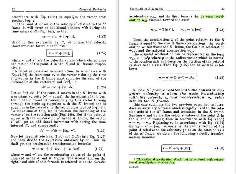

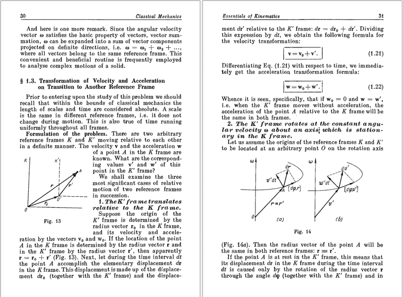

Thank you for such detailed reply..
I was going through I.E.Irodov's book: Fundamental laws of mechanics. On last page of the attachment(relevant pages of the book are attached below) it is mentioned that in equation 1.27 on page 32: $$\overrightarrow{a} = \overrightarrow{a^{'}}+2(\overrightarrow{w} \times \overrightarrow{v^{'}}) + (\overrightarrow{w}\times (\overrightarrow{w}\times\overrightarrow{r}))$$
that the third term is called axipetal acceleration, about which it is also mentioned that at the bottom of page 33 that it should not be confused with the conventional (centripetal) acceleration.
What I could understand after reading these pages is that even in inertial frame of reference(the K frame according to the pages pasted below), the expression for acceleration radially towards the centre of the curve that the particle is transiting is called axipetal but NOT centripetal.
So now the question is, how is the expression of centripetal acceleration derived, if it's different from the axipetal acceleration..? Up until now, i used to think that the expression that has been described here as axipetal acceleration is the centripetal acceleration, but now this book cautions that these two are different.
How is it different and if it is different then how does one get the expression for the centripetal acceleration. ?
I have been searching the internet for answer, but even after having searched for days, I couldn't find any answer to the above question..
First of all your equation from Irodov is confusing in that all vectors in it are primed which does not make sense. It's a good thing you also posted the section of the book in which it appears as (1.27). Secondly, I assume you realize that the terms in (1.27) are similar to but not the same as the terms in K&K. Equation (1.27) is a transformation equation expressing the acceleration ##\vec{a}## in an inertial frame as seen by an observer in a frame rotating with angular velocity ##\vec{\omega}##. In a K&K you have the acceleration in a non-rotating frame expressed in polar coordinates instead of Cartesian. Now for your questions.
The standard derivation of the centripetal acceleration considers an object in uniform circular motion of radius ##R## about a point with constant angular velocity ##\vec{\omega}.## Then $$\begin{align}

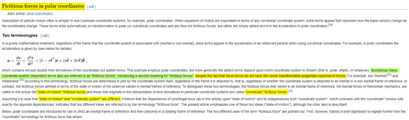

From the wikipedia page that I had posted in post#13, I'm posting the relevant part here below. The part which is bothering me now is the line written in the image below: "Sometimes these coordinate-system dependent terms (in the expression for acceleration in polar coordinates(inertial frame of reference)) are also referred to as as "fictitious forces", introducing a second meaning for "fictitious forces" despite the fact that these terms do not have the vector transformation properties expected of forces".
How come the vector transformation properties are not applicable to the coordinate-system dependent "fictitous forces" (which by the way are real acceleration/forces according to Kleppner and Kolenkow)?
Because they are cross products which are pseudovectors that do not have the same transformation properties as polar vectors. BTW, "pseudo" in this context means "fake" not "unreal" or "non-existent".
