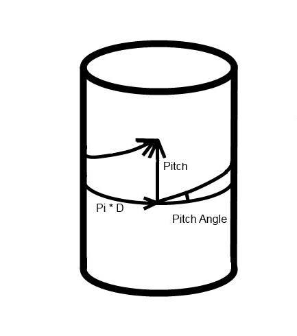

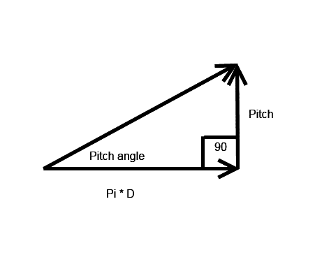

Lets say you are driving a screw into a block of wood or into nut one turn. If you were to mark a point on the screw with paint you would see that it moves in two ways at the same time..
1) It moves around the screw one turn, which is a distance equal to the circumference = pi * D
and at the same time..
2) It moves parallel to the axis of the screw a distance equal to the pitch of the thread.
These two motions are perpendicular to each other. 2) is parallel to the axis of rotation 1) is perpendicular to the axis of rotation.
If each of these two distances are drawn out on paper perpendicular to each other as shown below then the hypotenuse represents the distance that the point travelled.
When/if you have studied vectors you will recognise this as the head to tail method of adding two vectors.

I tried to draw the triangle wrapped around a cylinder that represents the screw...
Sir, I OWE YOU BIG TIME.. Your reply was just like a Christmas gift. Thanks a lot. Check this link. I was about to post it. It has the visualization as well but yours is way better now. Check it out "http://www.cadcamengineering.net/pitch-diameter-lead-or-helix-angle-and-percent-of-threads/".

The force required to push an object up a hill depends on the slope of the hill NOT the length of the slope. It's the same with the power screw. The torque is the same regardless of how many turns or fractions of a turn you make. If you made the triangle bigger it could represent 2,3,4...n turns but the pitch angle would stay the same.
If raising a load of mass m the force f will be equal to m*g and all of that has to be lifted even if the nut is only turned a fraction of a degree. The torque required will be as per the equation in that link.
