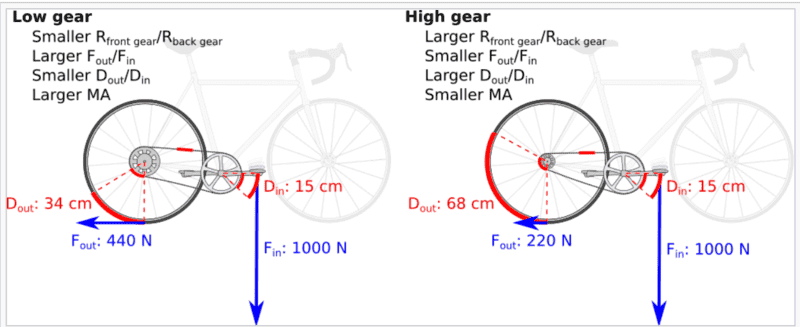

Thanks everyone. I am noodling with these concepts as I am trying to better understand how the gears in a bicycle, the force on the ground and the input and output power work.
For example, assuming negligible air resistance, rolling resistance, internal resistance, let's consider a bicycle in low and high gear. The cyclist introduces the same input power ##P_{input} =F_{in} v_{pedal}## in both cases.
CASE 1: low gear. The force of the foot on the pedal ##F_{pedal} =1000N## is transmitted by the chain to the back cassette to eventually produce a force on the ground ##F_{ground}=440N## pointing in the direction of motion.
CASE 2: high gear. The force of the foot on the pedal ##F_{pedal} =1000N## is transmitted by the chain to the back cassette to eventually produce a force on the ground ##F_{ground}=220N ## smaller than ##F_{ground}## in low gear.
My question: does it feel very hard to pedal in high gear because the force on the ground is small? If ##F_{ground}## is small in low gear, the resulting bike's acceleration is small which means that the bike would speed up slowly. But why does it feel hard to pedal in high gear? From experience I know that the bike reaches a faster speed in low gear than in high gear for the same number of pedal rotations.
The output power is ##P =F_{ground} v##. In high gear, it does not feel hard to pedal because the force on the ground is larger (##F_{ground}=440N ## in the above example).
The output power ##P_{low gear} =F_{ground} v## seems smaller than ##P_{high gear}## since the smaller ##F_{ground}## in high gear would produce a smaller increase in kinetic energy over time...

fog37 said:
My question: does it feel very hard to pedal in high gear because the force on the ground is small? If Fground is small in low gear, the resulting bike's acceleration is small which means that the bike would speed up slowly. But why does it feel hard to pedal in high gear? From experience I know that the bike reaches a faster speed in low gear than in high gear for the same number of pedal rotations.
Because for a given amount of acceleration, you have to apply less force on the pedals in low gear.

Are you assuming the same speed over ground here?
Feelings are subjective. You are assuming the same pedal force but there is less pedal movement in height gear. That migth "feel" like it is resisting more to being pushed. Also, the acceleration of the bike is less for the same pedal force.
##F_{ground}## is higher in low gear for the same pedal force. Look at you diagram/numbers.

I guess I was incorrect. Given a certain input power ##P_{in}## determine by the force on the pedal and by the cadence, the output power is actually the same in low or high gear.
I understand sophiecentaur's point but it is fun to understand those general concepts (levers, torques) in a real world application like a bike.
As far as the feeling of working harder in high gear than in low gear: it may just be the perception that with a single pedal rotation the acceleration is small (since the the ground force is smaller) but the speed increase is larger in high gear. Is that really true? That confuses me: the force on the ground is smaller in high gear than in low gear. The achieved speed in high gear is higher since we moves a larger distance in the same amount of time compared to low gear.
How does the smaller force in high gear manage to produce the larger speed in the same amount of time when compared to low gear? I tend to think that the large force generated in low gear would bring the bike to a certain speed in a shorter amount of time and that a larger speed would be achieved in low gear than in high gear over the same distance traveled by the bike...

One problem you're having is that you're examining one or two static setups and then trying to apply your intuition to them. In reality a person riding a bike is a very dynamic system that goes through power changes, speed changes, and gear changes as the situation demands, and you aren't taking any of this into account.
Here's the thing. A multi-speed bike is like a car. It has an engine (you) that provides the force and power and it has a transmission that takes an input rotation and converts it into an output rotation to vary the output force, torque, and rotational speed. But why would we need to do this to begin with? Well, just like a car engine, our bodies cannot provide the same force on the pedals over an infinite RPM range. We start in low gear and quickly 'redline', where we just cannot pedal any faster. So we shift to a higher gear to bring our pedal speed back down to let us keep accelerating to a higher speed. The tradeoff is that we give up a larger force on the ground for a slower input RPM.
The reason a high gear feels 'harder' than a lower gear is that our input force is converted to a lower output force, which makes us accelerate slower. At too high of a gear you simply cannot apply enough force on the pedals to overcome friction and air resistance to keep up your speed, or to overcome gravity if you're trying to go up a hill in high gear, as your output force is only a fraction of what you're putting in. In these situations you shift to a lower gear to make things 'easier'.
Another thing is that shifting to a gear that's too high is similar to staying in low gear too long. Both result in a reduced force applied to the ground. In high gear this is because of the greatly reduced mechanical advantage, while in low gear it is caused by a greatly reduced input force on the pedals thanks to the very high pedaling speed. Note that in the latter case you still expend a lot of energy and get tired quickly even though your force on the pedals is not very high. This is because most of the force applied and energy spent goes into accelerating your feet and legs up and down, not into rotating the pedals. Hence why we have the bicycling exercise where you lie on your back, raise your feet and legs into the air, and pedal like you're riding a bike. Do that exercise as fast as possible and you'll find that you don't need pedals and a bike to tire yourself out.

Thank you everyone. I certainly don't mean to be confusing and mix mechanics with biomechanics with my questions. I ride my bike and realized that my mechanical understanding of what is going on is limited.
In summary, assuming:
##F_{pedal}=## input pedal force
##F_{ground}=## output force
##R_W=## wheel radius
##R_C=## crank radius
##R_F=## front sprocket radius
##R_B=## back sprocket radius
## m=## bike mass
The output force on the ground propelling the bike forward is $$F_{ground}= \frac {R_C R_B} {R_W R_F} F_{pedal}$$
The bike's acceleration is $$a= \frac {F_{ground}} {m}$$

fog37 said:
How does a small force Pground applied to the bike correlates with the the bike's velocity v, which increases as the bike moves, being larger than when the force is smaller?
The OP still seems to be having a problem relating the 'gear equation' to what you get from a certain amount off pedal force. It all goes back to simple levers and I already advised starting with that most simple model. There are no surprises here - just a need for proper interpretation of the theory. I find his verbal version of it more or less impossible to make sense of.
Hello everyone, things are making more sense.
I am left with this dilemma though: as we change from a low gear to a higher, even without lifting the pedal from the accelerator, the engine RPMs go automatically down...Why is that?
To summarize, we start the car from rest and need a lot of force to cause it to move. First gear is the gear that provides the most force at the tire to accelerate the car. As we press on the accelerator, the engine's rotation increases and the torque also increase up to a point and the decreases. In first gear, the car eventually reaches a maximum speed ##v_{max}## and the engine's RPM are very high. The torque at that $v_{max}$ in first gear is matched by the net resistive torque. It is time to shift to 2nd gear and the engine's RPM automatically decrease...The same happens with the bicycle: our legs don't go round as fast when you change up a gear on a bicycle even if we don't slow down our pedaling...
Thanks
Car? What car? I thought this thread was about bicycles...?
It wouldn't work on a regular bike because there is a freewheel. It's easier to hop into a car. (But you can brake with a fixed wheel on a bike.)
The answer has to be that the engine turns into a compressor, pushing air out of the exhaust at a higher pressure than the intake. Work is done to achieve that and the energy source is the KE of the car as it slows.
